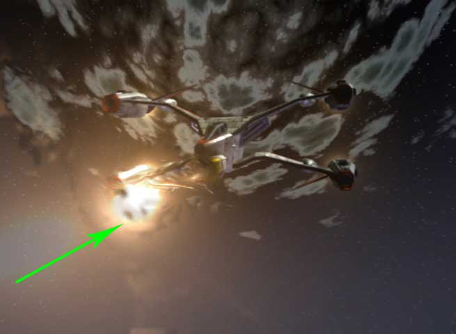

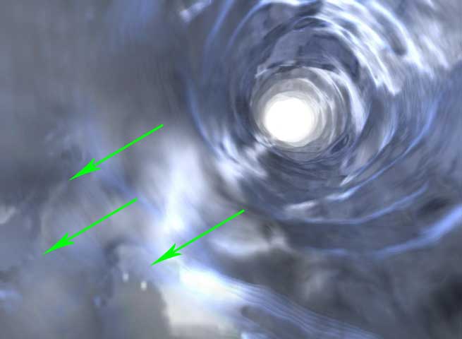

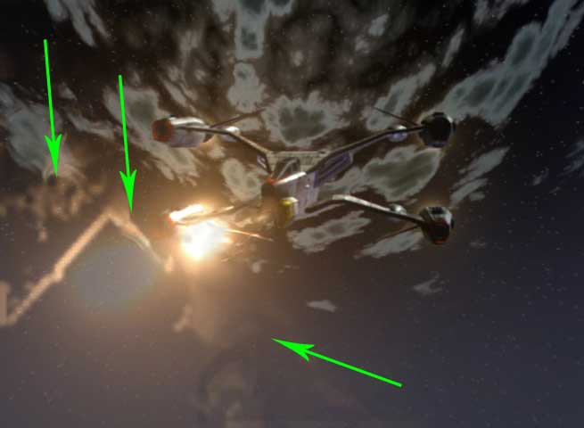

    The latest sequence was very short but if you look carefully you'll see weird motions in the stars near the edges of the space ships. There will also be weird distortions when objects move in and out of the frame.

  24. Got the files. Here's what I've found:
    SmoothFPS() doesn't seem to like a 486 line tall image. Sometimes it works, other times it crashes. Cropping it down to 720x480 fixed that problem.
    The last line of the SmoothFPS() function calls MVFlowFps2(). That function takes the frame rate as two integer values, a numerator and a denominator. The input to SmoothFPS is a floating point value. Rather than discarding the digits to the right of the decimal point (or rounding), SmoothFPS() uses scaled (multiplied by 100) integers to increase the accuracy. For example, if you asked for 29.66666 fps, rather than dropping to 29 fps or rounding to 30 fps, the internal calculations are handled as 2966/100.
    For some reason MVFlowFps2() screws up when those numbers become too big. I found that *50 works but *100 doesn't. To work around this problem I changed the SmoothFPS function a little. On the first line I changed "fp=fp*100", to "fp=fp*50". And on the last line I changed "den=100" to "den=50". I also tried using 10 instead of 50 and saw no difference (although I didn't compare very closely). Even 1 seemed to work.
    The final script I ended up with was:

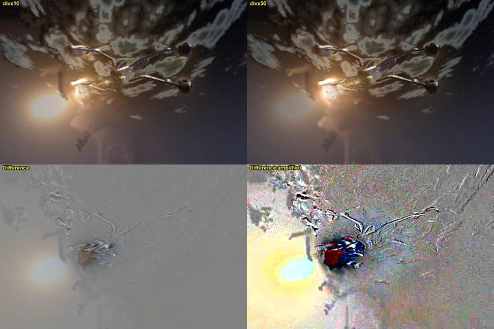

  29. Originally Posted by Cunhambebe
    -After converting the files, did you encode them as MPEG2 or XviD?
    Yes, Divx.
    -Did you see the artifacts that in fact is a kind of interpolation?
    Yes. This is the type of artifact one expects to see when simple motion vectors can;t fully describe the changes from frame to frame.
    -Do you think is definitely safe to change the figures (100 to 50) - only to the series of files that the height is 486 or I can change for those that are at 480 too?
    Yes, you can use 50 all the time if you want.
    -Playing the clip, did you notice any variation on its smoothness (using 50 as the new figure)?
    In theory, the smaller the value you use, the less smooth the result should be. I didn't see any obvious difference in smoothness between 1 and 100, but the rendered frames were obviously different:
    -What about encoding the AVI file (first converting from the "problematic" targa to AVI uncompressed as I was doing)? Do you see anything wrong with this (loss of quality)?
    Since TGA files are RGB, loading the sequence into VirtualDub then saving as uncompressed RGB will not cause any loss of quality, just bigger files (your TGA files are RLE compressed, a lossless compression scheme).
    Can I change the value SmooothFPS to 24?
    Yes, you can change it to any frame rate you want.
    It's funny because 100 seems to work here for this sequence...
    It might be a version difference. I download MVTools a year or two ago. You probably got a more recent version. 100 worked with the sequence you sent a few weeks ago.
