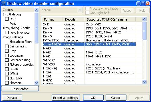

Actually in the above screen shot you would need to enable DivX 4 support (also maybe H.264). Think that was fixed (mp4v moved from DivX4) in newer builds
