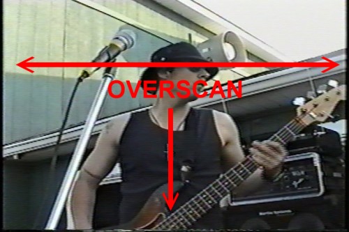

You sure it's not the overscan area? This is normal footage from a analog hi-8 cam:
I'm not too sure what you mean by this!
I'm using a Sony FX1.
Could you please be a little more specific?
Thanks.
Martin -
That's a digital camcorder so it shouldn't be present. Sorry can't help you.
