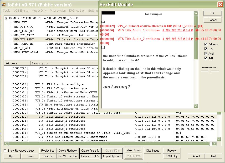

    to finish my job I only lack to edit some IFO files and can't understand how to rewrite the values I need using ifoedit.
    on the net I've found many how-to's about specific tasks to perform with ifoedit, but how can I replace this values? by double-clicking on'em I reach an edit window but there I can't do what I need.

    When you open the VIDEO_TS.IFO, do not change the page. Left click on VTS Audio you want to change.
    After changing the attributes, refresh the page and it will be displayed.

    thank you megahurts, I changed the underlined numbers by modifying the attributes in the main window, edited the values in the parenthesis and made all the settings OK, but I can't listen my audio..
    now I tried editing ifo audio attributes in the vobblanker process but it lead to norhing...

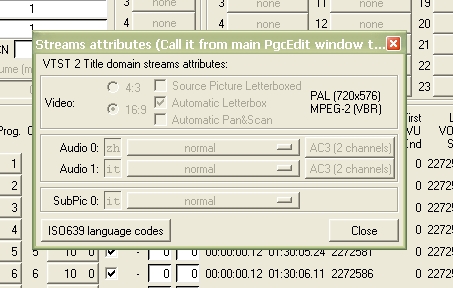

  4. If you're remapping audio streams, or changing their attributes, or changing the number of streams after having removed one or more, it's much more easily done using PGCEdit.
    Open the DVD in PGCEdit, double-click the video in the left pane, and have a look.

    yes, I tried this also but the edit panel was kinda 'freezed', however the values are correct because I changed them in vobblanker using the ifo of the remuxed video..
    in the vobs there is all, video and subs.. I've worked only on the main VIDEO_TS, should I edit all the single ifo?
  6. If you want to "unfreeze" that screen, go back to the main screen and hit the green reel of film looking icon up at the top.
    So, what's the problem again? You don't hear the audio? You don't hear either the Italian or the Chinese audio? When don't you hear them? When playing the DVD, or when playing the Vobs, or both? If just playing a Vob, you're more likely to hear just the Chinese audio. If playing the DVD in something like PowerDVD, you should be able to choose one or the other. Can you usually hear AC3 audio? Do you have the AC3Filter installed?
