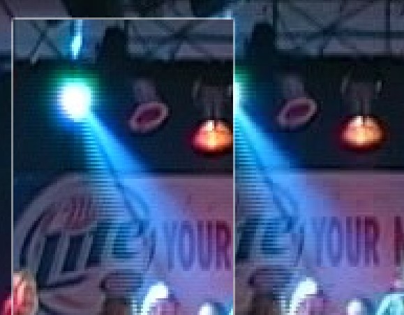

DV tape all the way. take this example:Originally Posted by numbfinger
On the left is from a Canon GL2 which is a prosumer cam. On the right is the same file encoded to 8000kbps using Uleads version of Mainconcept . The GL2 isn't the best cam in the world and Maincocept isn't the best encoder but relatively speaking the left image is about the most you can expect form any DV cam, the right would be the most you could expect from DVD compliant MPEG . Not a huge difference but still there. Also bear in mind those MPEG cams simply aren't all that great, read some of the reviews at camcoderinfo.com. Lastly they don't make good cams that record to disc if that tells you anything.
