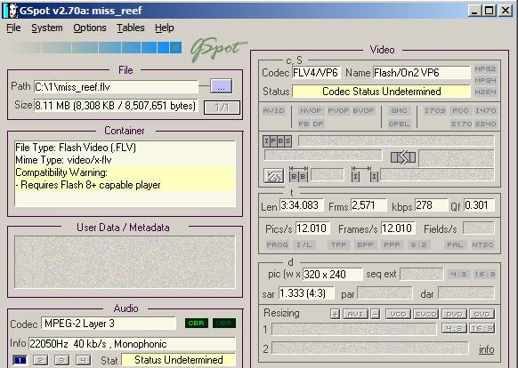

Is there a program to know what codec uses this FLV? -
Could be using the new On2VP6 (or is it 7 or 8?) codec, which won't yet be supported by all viewers. And there'll be a difference between viewing it via Browser plugin vs. Standalone player.

That Gspot says 12 fps? Sounds jumpy...This is how they used to make video on the internet small...by dropping half the frames. Now, the frames are kept but the kbps are reduced. -

I have VP5, VP6 enable in ffdshow, but still doesn't work the video, just the audio. I can't even convert the FLV file to another format like AVI or WMV to upload it to youtube or other. Can anyone tell me where to get the FLV4/VP6 codec? -
