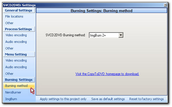

    Well burn settings are as follows:
    As for the second issue, i would need to see your log files.... Log files are kept in the "logs" folder under where you installed the program.

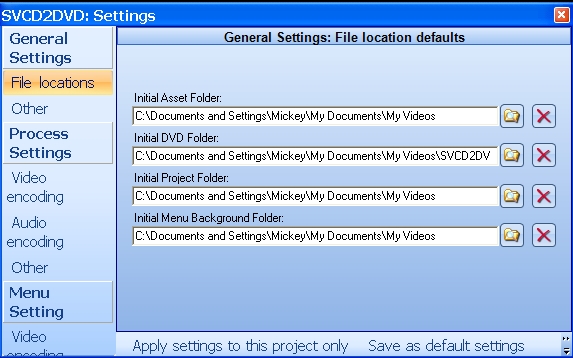

    Thanks for the screen print. I now see part of the problem. My screen doesn't look quite like this. Each item on the left takes up two lines and I can't make my window bigger. The last item I see is
    Video
    Encoding
    and I can't figure out a way to scroll down lower. I tried using arrow keys, tab keys, page up and down, enter, etc. I also reduced the font size on my laptop to see if that helped and it didn't. There must be a setting that is off somewhere.
    I will also attach a screen print so you can see what I mean.
    When I get home tonight I'll get the log files if I still haven't figured out how to solve the problem.

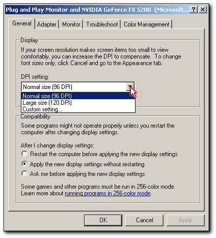

    Have you by chance changed the display font size for your system? Setting to large or extra large fonts would probably cause this.

    Yes, I had changed my fonts to "larger" as I have bad eyes. When I discovered the problem I then switched it back to "normal" and restarted the computer but it had no affect on the settings screen. I sure hope I don't have to go to "smaller". :>)

    Can you post a screenshot of what you see?

    Just for the record, I have my computer set to normal fonts and here is what my window looks like. Sorry, but I don't know how to put it directly in the post.

    Actually problem is not solved after all. When I maximize the window the save links at the bottom are off the screen and I have no way to save my changes. Is there some other way I can resize the window? I tried changing the resolution but I'm already at the maximum.
    Now what?

    Well if your fonts are normal i suspect your dpi is not:
    Either way you could max to set the burn settings then double click the title bar again to see the buttons....

    The dpi is set to normal size as well. It must be something with my laptop. I've been able to work around it.
