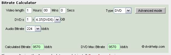

    Use the calculator to figure the highest bitrate for the minutes (and audio settings) that you want to use.
    https://www.videohelp.com/calc
    IMO, 6Mb/s VBR is inadequate for handheld camcorder material. I'd use 8.5Mb/s or more.

    Maximum per the calc is 9.57Mb/s (9750 Kb/s) for video when audio is compressed to 224 Kb/s. CBR should be used for higher bitrates.
