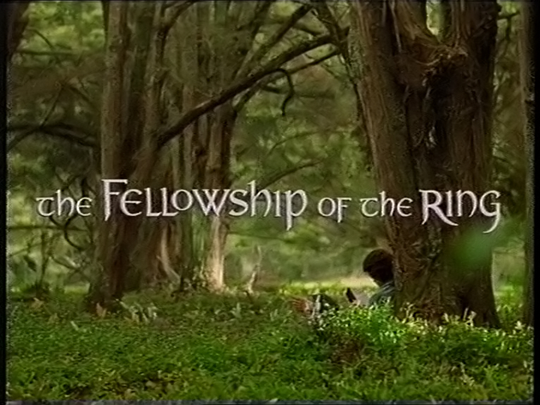

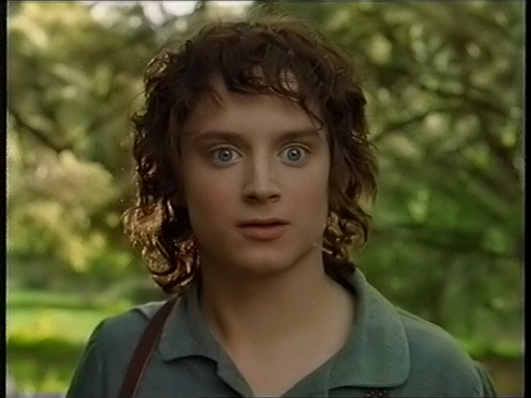

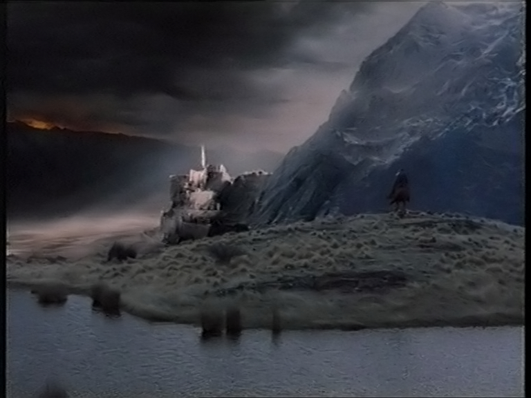

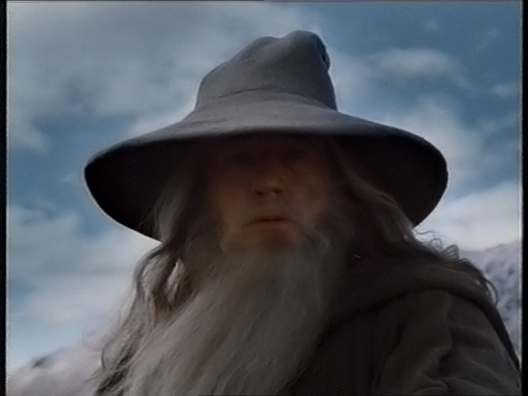

  20. Member StuR's Avatar
    Sep 2006
    vhelp, thanks for the reply always interesting to hear others opinions - even if you don't like or agree with them
    I'll try and answer some the pionts you make.
    Firstly the L.of.Rings.pt1 VHS is an origonal copy - no MV protection.
    I don't need to copy it 95+% of my tapes are old home rec. but I'm using as good an origonal to gauge the quality of the captures and equipment. The Sony GX300 rec. at HQ with its NR off, to minimise it's sub-prime rec. characteristics .
    Of the two I prefer the Soft pic setting as the auto is to grainy. I wish the HS860 had auto/soft1/soft/soft3 settings or an old fashioned slider and I'd set it a little down.
    It gets ever more complicated as the GX300 maybe contributing the the grain in the Auto setting so when I can get a better DVDRW with useful NR it may improve the Auto PQ?
    As for the Soft setting detail is lost i.e. title sequence -tree bark, hair in frodo CU. But it stops the detail noise in the moving image. Grain in stills is deceptive as it gives the detail, but it shimers in vids.
    You obviously prefer PC capture, but I just don't want to go down that road, I'd like to get the best I can from a direct DVDRW cap. I now this rules out a great deal of great software but it's not going to be practical for me.
    R.E. Fifth Element Pic.
    This is a very nice example, it looks to have a good balance between detail and noise. It actually reminds me of the Titanic caps that gshelley posted using his W-VHS > Tosh DR4. I was looking at some saved forum pages last night and those Pics where great.
    What I mean is the fine 'airbushed' quality of the grain. From what I can see I'd be pleased with that.
    Your HR-S3910U from what I can see is a US model of the SVHS JVC's that did not include the TBC/NR. Have you ever been able to compare it to these other models? Was this played using the Auto or Soft picture mode.

  24. Member StuR's Avatar
    Sep 2006
    U Segas
    At first on CRT screen your copies looked darker than the orig ones and I wasn't impressed. But saved pages as usual and veiwed on my laptop and they look the same brightness afterall and layering the pics over the orig in Photoshop and flicking they look much better. They have softness with retained detail, ie. CU frodo-the eyes are sharp a bit grainy in the skin?, titles -not so much deference, CU2 -smoothed and left more hairs in the beard, Landscape -to me best example.
    It's not a huge difference this is all looking for small % differences, but its impressive what can be done using software, if you use Pshop to blur the auto images they don't look as good at all as your examples I'm puzzled how, but it dosen't matter, it just looks better and that all that matters.
    The post starts by asking for the best VCR, I personally wouldn't claim to know that and there's likely to be no such thing. But if you where still interested in the HS860/960 let me know and I'll PM you some info tomorrow. Saw one for sale on web, didn't sell but could still be available 960 £65+Pp. actually considered buying but there's no point as it's essentually the same after double checking the manuals (inset edit and jog dial inc. on 960 same pict. controls though). No, I'm not recommending it, not qualified to do that just letting you know, I've seen a few HS1000's go for £100-140ish on ebay recently I don't know how they compare on PQ. The HS1000 can be considered a later version of the fs200 (1980/70) but once again be certain of their true comparision.
    vhelp
    I think they all should be SVid via a selectable scart lead (either Comp/svid/RGB) shawshank may have been Comp? haven't got it written down. Recent pics are all svid due to new cables.
    I know what you mean by leaving all filtering off on VCR, but remember I'm not using PC software to enhance so its only the VCR or the DVDRW that sorts out PQ issues (about 300+? Vids to do!)
    Soft setting is distructive on a good tape but I've much worse due to recordings from a poor arial and age. The HS860's 3DNR is very mild I've thought about it a good bit and I think it should be used. Honestly I've read alot of the debate on these issues and I think until I change DVDRW that's the position. Now I'm probably going to end up with a JVC DVDRW so the NR will be present and not optional (as with my Sony) so I'll need to do some tests on that setup if it ever happens.
    I also have the Titanic,
    but haven't taken the plung to break open the shrink-wrap
    Probably best not to bother, it sinks This is the one I meant
    https://forum.videohelp.com/topic287476-30.html
    Davideck
    There is also a difference between "restoration" and "preservation".
    I'm thinking more restoration due to age but the L.of R copy would be more preservation I suppose as its a good Q example.
