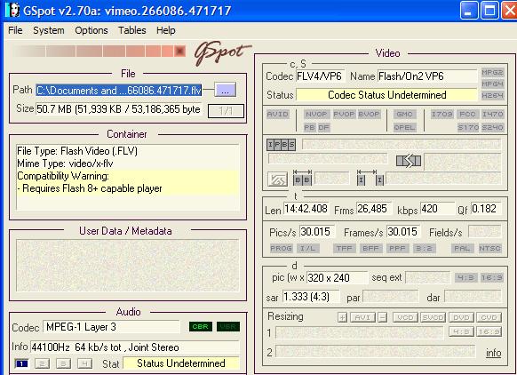

Yes, moogaloop.swf is indeed the 'player' shell.
Is this the video you're looking for? (right-click and save)
http://86.media.vimeo.com/d1/clips/2007/02/14/vimeo.266086.471717.flv?72a7ed
I found that link using the UnPlug extension. I wasn't sure if it's the same, though, because I haven't watched the entire video, and haven't yet noticed a frame that looked like the frame that appears when you stream the video normally.
Note that if you don't mind having a handful of Firefox extensions around, you can have more than one video-saving extension installed - I've had no problem with the ones I have (and Greasemonkey scripts in addition to them) co-existing.
If cameras add ten pounds, why would people want to eat them? -
Yes, it is. Excellent! Thank you!Originally Posted by Ai Haibara

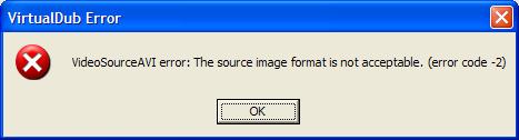

OK, back again.
Now I've got the FLV file, how do I trim it? Simple cuts to keep only the bit(s) I want.
I've had a look in the Tools and searched in the forums, and no FLV editing tools seem apparent.
I've tried using Internet Video Converter to convert to Xvid's of 320 x 240 (original res) and 352 x 240 so I could then chop bits out in VirtualDub or VirtualDubMod.
Both report:
I'm used to working with DV AVI where everything is smooth first time.
Just doing this as a favour for a friend.
Cheers.There is some corner of a foreign field that is forever England: Telstra Stadium, Sydney, 22/11/2003.
Carpe diem.
If you're not living on the edge, you're taking up too much room. -
You may be able to convert it to AVI using ffmpeg (or any GUI that uses the more recent versions of FFMPEG, like SUPER ). Also, you can try FLV Extract, which will demux the FLV into an AVI stream (though you'll probably need to have a VP6(2) codec installed... ffdshow does appear to support it.) and an MP3 (or other) audio stream, along with a timecode file. You might be able to work with those.
I don't know about Internet Video Converter, or how well it works, since I've never looked into it. But from the images you posted, I at least know it uses VirtualDub at some point.

SUPER worked exactly as per its name. It took my FLV and encoded to Xvid which I could then chop bits out of in VirtualDub and VirtualDubMod. Sweet! Thank you.Originally Posted by Ai Haibara
The images were directly from both VirtualDub and VirtualDubMod - Internet Video Converter doesn't use either.Originally Posted by Ai Haibara
