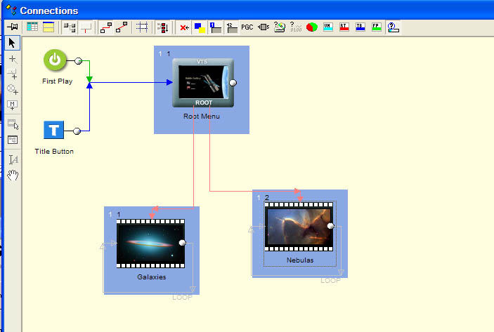

I have built a DVD with two movies in it, "Galaxies" and "Nebulas".
In the main menu, they are linked to individually, with galaxies being the first choice. Then once in the movies, there are chapter markers. Both movies are looped.
When played, and you are skipping the chapters in galaxies, once you try to skip to the last chapter, it instead jumps to the begining of the nebula movie.
What can i do to prevent this?
Cheers

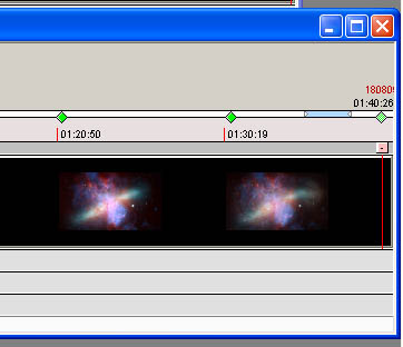

and as you can see i have a chapter marker right at the end of the galaxies movie
thoughts?DOWN WITH STUPID! -

the disc was burnt with the dummy chapter that i showed earlier yesDOWN WITH STUPID! -

I think the tricky thing here might be when you hit the NEXT button (before or after the layer changes). Try hitting the NEXT button after the layer change to see what happens. Judging from your pictures, you are using NTSC, it looks like you can try hitting NEXT at around the 1:39:30 mark
