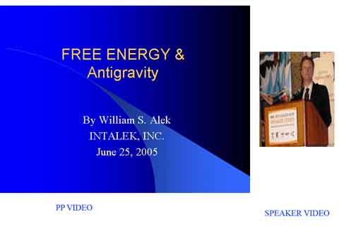

Ok,i wll try to explain you the situation better.My English are poor! I want to capture an lecture and publish this lecture to the internet live (Video streaming) I will have an video camera pointing to the speaker.This is the first source.The second source is the powerpoint presentation of the speaker.He will have an laptop.His presentation will be the second source. Check the picture I have made.I want to join these 2 videos in one and upload this to the net with media encoder.
Thank you very much for your help
This is what my fellow students i would like to watch from the internet.This project is very complex.Do you have any ideas? -
If you have both the PPT and the speaker video as video files (avi, mpg or similar), you can do this with AviSynth.
You must have one more video source (or still image), and that's the background the ppt and speaker is pasted into.
Found this when googling for AVISynth PIP that explains the basics.
http://forum.doom9.org/archive/index.php/t-53538.html
Here's a small script that'll take 2 AVIs, and place them diagonally inside a jpg background for 300 frames:
Code:bg=imagesource("C:\pictures\winter.jpg", end=300).ConvertToYUY2().bicubicresize(720,576) pip1=avisource("c:\video\powerpoint.avi").ConvertToYUY2().bicubicresize(400,300) pip2=avisource("c:\video\speaker.avi").ConvertToYUY2().bicubicresize(400,300) a=layer(bg,pip1,"add",255,20,20) b=layer(a,pip2,"add",255,300,256) return b
You can also preview it in Virtualdub or some video player like MPC.
