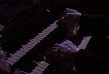

    Is anyone familiar with a program that can adjust the brightness of an mpeg or other formats? Free or otherwise. I have some video clips that I have taken and I would like to adjust the brightness, etc., before burning to a VCD. Thanks for any advice.

    Thanks for the quick reply. The enclosed jpeg is 1 frame from an mpeg I have and would like to adjust and burn.
    Mar 2007
    Sorry about that, but no image posted. Is there a format I should be using? I used JPEG in the allowed formats list but can't view.

    Here is the jpg
    Mar 2007
    JPEG
    Mar 2007
    Sorry I had BBCode off

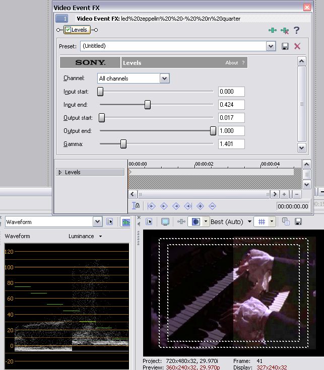

    That is a dark one.
    Here is a quick correction using the Vegas levels filter. Most editors will have similar levels tools.
