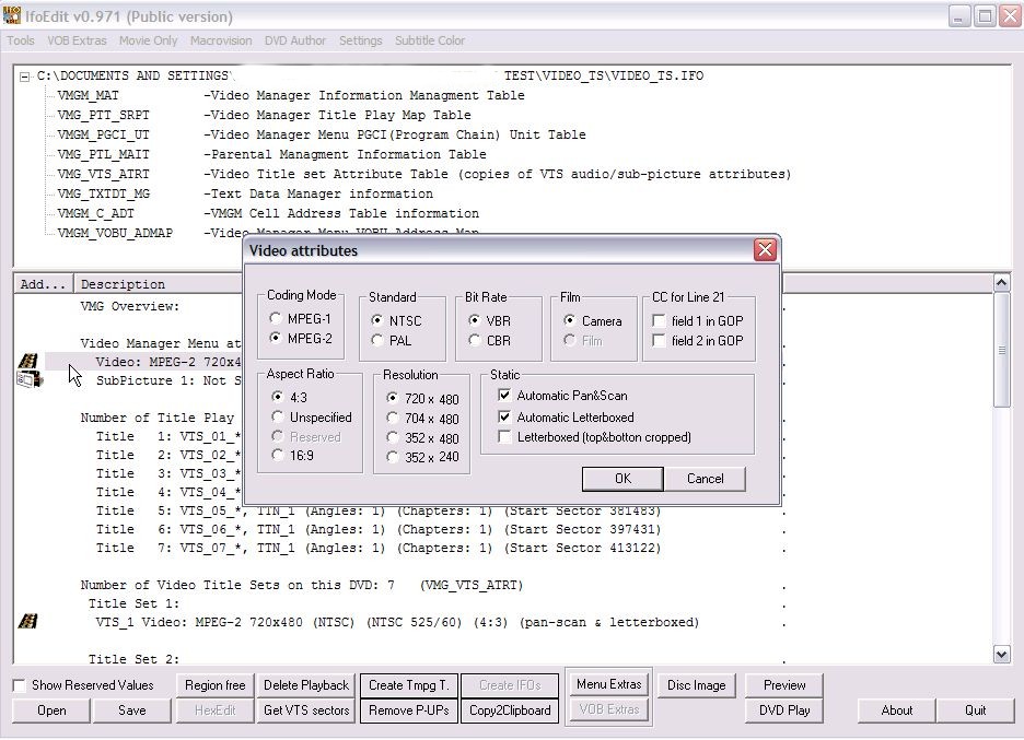

Many people(including myself) who made DVD's from home movies have problems with the picture stretching on 16:9 tv's.
One easy solution is to change the flags on the IFO files.
Tools you will need:
IfoEdit

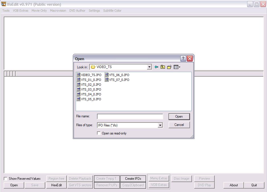

1.Rip DVD to HD.
2.Open an IFO file and double-click on each MPEG file,make sure the Aspect Ratio is set to 4:3 then put a check in "Automatic Pan & Scan" and "Automatic Letterboxed",hit OK and Save(VERY IMPORTANT).
3.Repeat for each IFO.
4.Select "Get VTS sectors" and answer OK when asked.

The problem is many authoring programs(esp. older versions) forget to put the flags on the IFO files.So if you play a 4:3 AR DVD on a 16:9 tv it will be stretched horizontally,if you play a 16:9 on a 4:3 tv it will be squished horizontally.Some DVD players such as Oppo can display the correct AR if the flags aren't there but most DVD players can't.
