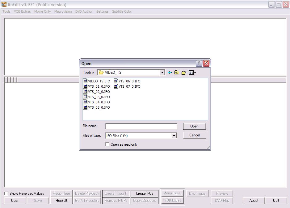

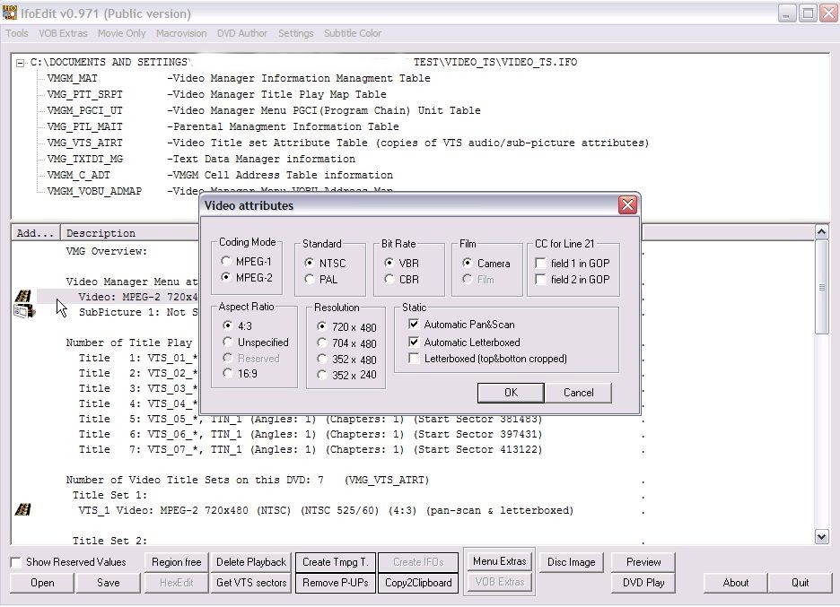

It seems to me that the only way to do this is to actually reformat each frame of the mpeg stream. MOVIEGEEK suggested that I only need to edit the .INF files. If I can realize my goal by simply instructing the DVD player to display in 4:3, that would be great. What I don't want is to send out an instructions manual to friends and family every time I send out a DVD.
If anyone is taking a real interest in this problem (i.e., if things seem like they should be working), I would be happy to upload my .INF files and the first VOB. (MOVIEGEEK, I could also upload my INF files if you think that there might be another problem setting).

I wouldn't belittle the advice if I were you, as it's on the money. You have an Oppo, you say? I'll assume you didn't get it a couple of years ago and are using an early firmware. If you are, upgrade it. If your player is more recent than that, go into the player setup and set the TV Display for Wide/SQZ; not either of the 2 Normal settings, and not Wide. That way 4:3 material will be shown with pillarbars on the sides, at the proper Aspect Ratio. Your 16:9 DVDs will also still play properly. When you checked out MOVIEGEEK's "fix", weren't your Video Attributes 4:3 already?If anyone is taking a real interest in this problem... -

ecco, I had the same problem with my Oppo 971. Take manono's and others' advice, it's either the player or TV setup issue. You do dot have to do anything to DVD structure in IFOedit. Your Netflix analogy doesn't hold in this case. I was a little confused when I set my Oppo to Wide mode and movies were displaying incorrectly on my 16:9 TV. Anyway..
Make sure the Oppo is set up to display as "Wide/SQZ" mode and that should fix it. If not, then your TV is somehow in 'Zoom' mode when it s/b set to Normal display. -
