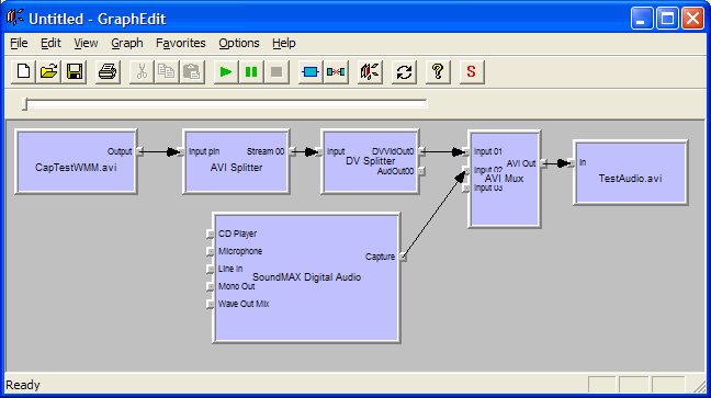

You could use GraphEdit to build a DirectShow graph with the cam and soundcard as sources, and create an AVI file. You can strip out the cam's audio and replace it with the soundcard's.
Caveat: make sure you use 48kHz/16-bit stereo for your soundcard if mixing to a DV format AVI file. Using 44.1kHz/16-bit stereo *may* lead to problems since not all DV decoders support it.
Here's an example graph (you'd replace the .AVI file source with your cam's live input):
