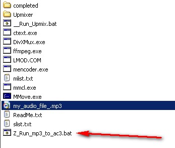

  2. Is it possible to get a AC3 file with a bitrate of 448kbps if i change this in mp3_to_ac3.bat?
    from:
    bepipe.exe --script "import(^upmix1.avs^)" - | aften.exe -acmod 7 -dnorm !char! -v 0 -b 384 - audio.ac3
    To:
    bepipe.exe --script "import(^upmix1.avs^)" - | aften.exe -acmod 7 -dnorm !char! -v 0 -b 448 - audio.ac3
    Or do i get issues on that, or sound distortion?
  3. Member Soopafresh's Avatar
    Jan 2004
    That should work fine.
    I'm not happy with the sound of the mp3_to_ac3 script yet. It is OK, but I need to remove the maximizing and limiting which was designed for movie audio and not really music. Better if Chopin isn't IN YO FACE !
    So, go ahead BUT make sure your MP3 files have NO spaces in the name -
    Bad: My Music File.mp3
    Good: My_Music_file.mp3
    I'll fix that in the next version, but until then, that is a limitation.

  5. Member Soopafresh's Avatar
    Jan 2004
    Update to v.06a -
    - No More .NET requirements
    - Spaces in File Name Support (I think...lemme know if there's a problem)
    - Updated Aften encoder to v.07
    - Mp3 audio to 5.1 AC3 encoding (and it's pretty fast, too!). File names can now have spaces.
    - Upmixed file destination is the "Completed" folder. See instructions in first post.

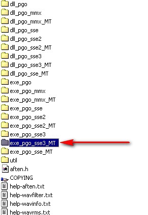

    Question, is it multi-core able?
    Thanks!
  9. Member Soopafresh's Avatar
    Jan 2004
    Yes, but the Avisynth script would require some tweaking using the plugin MT().
    http://www.avisynth.org/tsp/MT_07.zip
    http://avisynth.org/mediawiki/MT_support_page
    It'll take some testing. If you decide to try it, lemme know how it goes.
    The Aften encoder can be immediately multithreaded.
    Download http://prdownloads.sourceforge.net/win32builds/aften-0.07-win32-bin.zip?download
    and replace the aften.exe file in the upmixer folder with the aften.exe found in the zip file above - this folder:

    This small change to your Z_Run_mp3_to_ac3.bat should be good for all BassAudio supported formats.
    MP3/MP2/MP1/OGG/WAV/AIFF/WMA/FLAC/WavPack/Speex/Musepack/AAC/M4A/APE/MO3/IT/XM/S3M/MTM/MOD/UMX
    I've tested the formats below that I've added so far and they work fine with .mp3 extension in place of thier original extentions during encoding.
    They all used the WavGainLimiter OK so I included that too.
    @echo off
    rem BassAudio Supported Audio Format 2.0 - 5.1 Upmixer v0.6
    for %%a in ("*.mp2","*.mp3",*.mp4","*.mpa","*.aac","*.m4a","*.flac","*.ogg","*.wma","*.wav") do @echo "%%a">mlist.txt & @echo "%%~na">slist.txt & call :process "%%a"
    goto end
    :process
    type mlist.txt | lmod set cfile=[$1] >currfile.bat
    type slist.txt | lmod set sfile=[$1] >>currfile.bat
    call currfile.bat
    if exist audio.ac3  del audio.ac3
    if exist audio.mp3 del audio.mp3
    if exist upmixer\audio.ac3 del upmixer\audio.ac3
    if exist upmixer\audio.mp3 del upmixer\audio.mp3
    copy "%cfile%" audio.mp3 /y
    copy audio.mp3 upmixer /y
    cls
    @echo.
    @echo.
    ctext.exe "{0x1B}               Scanning the MP3 for Peaks...                             {\n}"
    ctext.exe "{0x07}.{\n}"
    @echo.
    @echo.
    cd upmixer
    mp3gain /f /c /r /k audio.mp3
    @echo.  > amplify.avs
    @echo SoftClipperFromAudX() >>amplify.avs
    cls
    @echo.
    @echo.
    ctext.exe "{0x1B}Determining the Amount of Gain to Add to the Audio. This Can Take Some Time...{\n}"
    @echo.
    @echo.
    avsamp upmix.avs | grep "Amplify" | lmod wavgainlimiter([$3]) >> amplify.avs
    if exist upmix1.avs del upmix1.avs
    cat upmix.avs amplify.avs > upmix1.avs
    cls
    @echo.
    @echo.
    ctext.exe "{0x1B}                   Encoding the 5.1 Audio Track...                      {\n}"
    @echo.
    @echo.
    wavi upmix1.avs - | aften.exe -acmod 7 -v 0 -b 448 - audio.ac3 >nul
    cd..
    copy upmixer\audio.ac3 /y
    ren audio.ac3 "%sfile%".ac3 & mmove "%sfile%".ac3 completed
    del audio.mp3
    del currfile.bat
    del mlist.txt
    del slist.txt
    :end
    EDIT:
    avsamp line now correctly positioned before cat upmix.avs amplify.avs > upmix1.avs
    More formats tested and added
    Added screenshots
