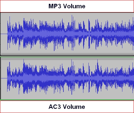

    * Demuxes stereo (2 track) mp3 from Divx/Xvid AVI and upmixes the audio to AC3 5.1
    * Resamples the audio to be compatible with Mpeg2 DVD - (48000hz), 384kbs

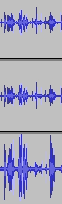

    If you're skeptical, have a listen to the individual tracks it creates. Here's the exact same moment in the audio in these three synthesized channels:
    -First, the Center Channel -
    center-example.mp3
    -The Surround (Rear Channel) with the Dialogue Removed ! - (Pretty Cool, huh ?)
    sr-left-example.mp3
    -The LFE channel-
    lfe-example.mp3

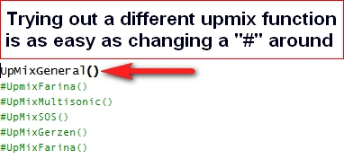

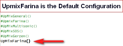

    Seven Different Upmixing Configs from which you can choose. See the instructions below on testing out a different configuration.
    Props go to the doom9 audio scholars and jagger for the upmix functions

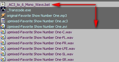

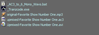

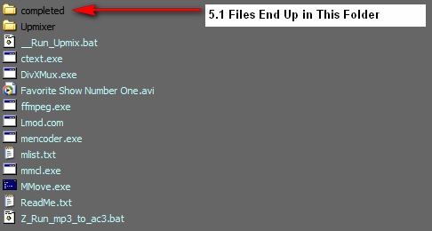

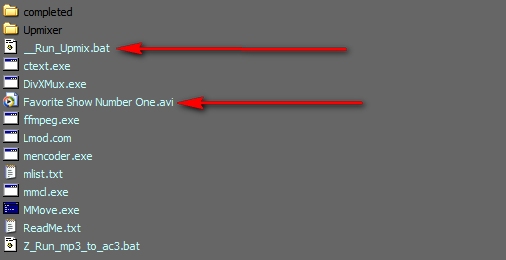

    1) Copy AVI into Same Folder and Click _Run_Upmix.bat
    2) When Complete, You'll Find a New AVI with 5.1 AC3 Sound in the Completed folder. You can also use the .AC3 File for a DVD conversion
    The Completed Folder Will Look Like This...

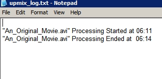

    3) Upmix_log.txt will Display the Processing Time

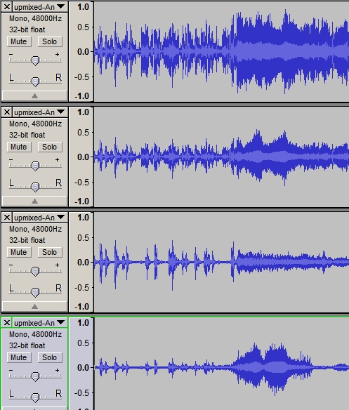

    4) If you Want to Analyze Each Track in the AC3, Run _AC3_to_6_Mono_Wavs.bat
    5) You can Load and Listen to Each Track or the Complete Mix in Audacity

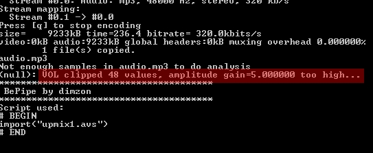

    A1=GetChannel( C, 1 ).amplify(0.6)
    A2=GetChannel( C, 2 ).amplify(0.6)
    A3=MixAudio( SuperEq( A1, "CENTER.FEQ" ), SuperEq( A2, "CENTER.FEQ" ) ).amplify(5.0)

    Wow, 6.0 . I hope others chime in on this. If the levels need to be boosted that much, I'll be happy to include those values as defaults.

    2) both the upmix.avs and soxfilter.dll file should be placed it the UPMIXER folder. Make a backup copy of the original upmix.avs file if you wish.
    3) There are 5 different kinds of upmix configs you can test out. They all sound different, so experiment and find one that pleases your ears. Open the new upmix.avs with notepad.

    Location: United States
    New Version V05 Released. Lots of Audio Quality Improvements.
    1) Audio is Scanned for Volume Levels and Prevented from Clipping. Dialnorm setting determined automatically.
    2) Default Configuration Creates Pretty Impressive Sounding Pseudo 5.1, including vocal removal on the SL and SR channels.
    3) LFE channel Lowpassed to 90hz instead of 120 for better separation
    4) AC3 File Is No Longer Deleted so you can use the file for a DVD project or you can convert it to 6-mono WAV files with the _AC3_to_6Mono_Wavs.bat File.
    5) And most importantly, you'll see that the volumes of Mp3 and AC3 are THE SAME. If your PC or AC3 decoder isn't playing the levels back equally, it isn't the fault of the batch file.
    * Download link in First Post
