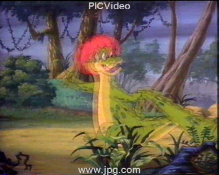

The ghosting you are seeing are because the deinterlace has duplicated both fields and you are seeing them simultaneously and not sequentially. -

On closer examination your sample appears to suffer from a partial field blending. That will make the ghosting very hard to eliminate. -

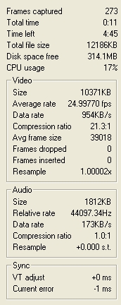

this is the current settings for virtualdub
Video
720x576
25FPS
Codec PICVIDEO MJPEG set at 15

I've only seen one frame from your video (and even that was processed by JPEG compression) but it looks like it has the typical partial field blending that often comes with NTSC/PAL conversions.

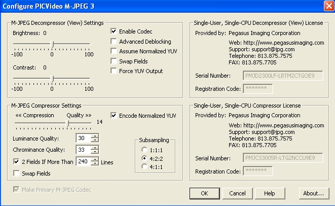

Capturing with VirtualDub shouldn't be a problem. Be sure you set PicVideo MJPEG to encode as interlaced (in the advanced tab set "Encode as interlaced if more than 288 lines").

heres a short AVI clip of what ive captured.
im guessing there isnt anything i can do about this?
PICVIDEO Codec was set to capture 2 fields if over 240 lines

When you capture, be sure that PicVideo MJPEG is set to encode as interlaced, especially if you are using the 4:1:1 color subsampling option. Encoding interlaced video as progressive frames can also lead to problems like this.

heres a picture of the settings in the compression for PCIVIDEO
ill include several pictures and you can check to see if its something to do with my capture settings

720x576
PICVIDEO MJPEG set at 14
