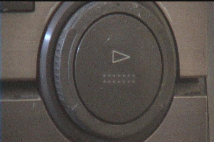

  13. Member edDV's Avatar
    Mar 2004
    Northern California, USA
    OK, here is my understanding. Is this wrong?
    Source is a simple DCR-TRV103 in wide mode (first and lowest Digital8 model) pointed at a circle. All my other D8/MiniDV camcorders produce this same result.
    Here is what it looks like in 720x480 over IEEE-1394 as seen in WinDV monitor.
    We all know that 720x480 pixels are not square. So here is the 640x480 square 4:3 version (H adjusted in Photoshop) which appears full height and horizontally squeezed.
    Here is the 853x480 square pixel 16:9 version again adjusted in Photoshop. The knob is round.
    This matches exactly what I see in a Vegas monitor in DV wide project settings and when monitoring it fills a 16:9 TV screen.
    PS: to see the wider image you need to double click the image in this web software to see the full width resolution.

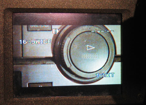

    It doesn't have the anamorphic option. The camcorder 4:3 LCD shows letterbox 16:9 while using the viewfinder (as edDV shows), but also outputs letterbox (it just adds black bars).
