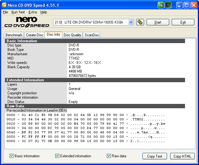

  9. My curiousity is getting the better of me. Could you use your ASUS drive and get a CD-DVD Speed <Disc Info> from an old dvd that is recognized in the Pio and then a newer one that does not recognize in your Pio for comparison sake? Here is an example of what I'm referring to:
  10. I Put this DVD+R in the Pioneer & it read & does disc info!
    I'll now do as you ask & put it in the Asus: -
    I then insert a newer disk into the Pioneer the drive spins up, the light flashes, then an empty window opens saying "CD Drive" (E). If I go to "My Computer" then look at the drive then I notice that the label had changed to "CD Drive" (E). So I move the disc to the Asus Drive & do a disk info I get the following!
    I tried a verbatim 16x from 2005 that reads OK on both drives. ???????????? Perhaps I have a bad batch of discs? I also just gave a friend a recently written Verbatim 16x DVD+R disc that won't read on either of my drives & he has no problem reading it??????????
