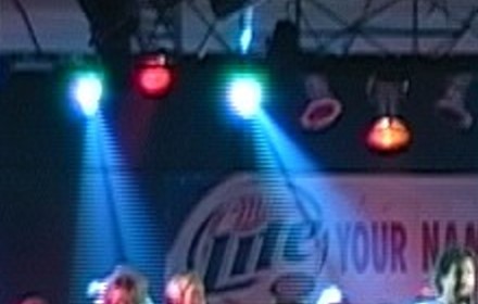

    The affects of deinterlacing will be seen during fast moving scenes and overall you have reduced the resolution. Here's some brief examples, this first pick is interlaced. Interlaced is comprised of two frames of video each in a seperate field. The horizontal lines in this example would be each represent a seperate frame. Note that these are zoomed.:
    When you deinterlace, coincidentally this was done with interpolation you combine the two frames.
    This will look better on computer monitor than the interlaced example when played, however most software will do this on the fly so you really have no need to deinterlace. Also though it may not be evident in this pic you have also thrown away half the resolution.

    Here's a 2 frame animation to represent the lost resolution, both frames are from a the same single source. they were deintelaced using interpolation, the only difference between the two is what field was kept, note the dfference between the girls hair in the lower left.
    One thing to note is this is gif and it's limited to 256 colors so some of what you see is the result of the reduction in the color pallete.
