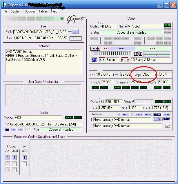

    Here's a Gspot screen from a PAL DVD VOB. The bitrate is circled. The video is about 7.5GB with a playing time of 2.5 hours. I would have to Shrink or re-encode it to fit on a DVD-5. A bitrate calculator says the bitrate should be 3837kbps to fit a 4.37GB DVD-5. That's a little too low a bitrate for full DI, so 1/2 D1 should work about right.
    m
    EDIT: If the files get a whole lot bigger by the time you burn them, either they are being re-encoded or something like your audio is at the wrong settings. Gspot should tell you that. I use MP2 or AC3 for audio. LPCM audio will be very big. Authoring should only add a hundred or so MBs to the file.

    The 10080 info is just reading the headers, it's not the actual bitrate.
  9. Mod Neophyte Super Moderator redwudz's Avatar
    USA
    theewizard, the 10800kbps is the system bitrate, Gspot always shows that. It's not the encoded bitrate.
    Though, if indeed he had a 2 hour video and it came out at 9GB, that would be close to that bitrate.

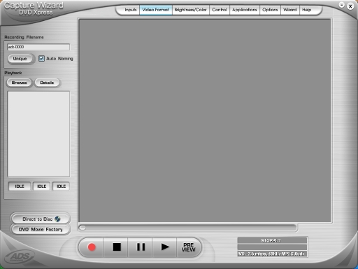

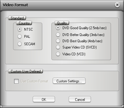

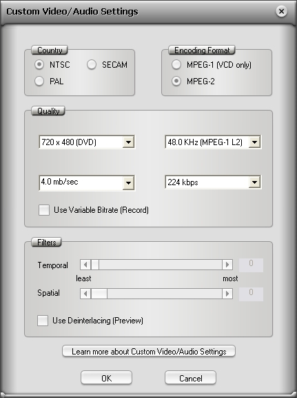

    pics from my run of cap wiz
    click on video format
    click on custom
    choose the settings you want
    here it is set for 1/2 D1 (352*480 ) at 3000k / 3mbs
    play with the settings until you find , a combination that pleases you.
    the right side colum mpeg1 lpcm ,48khz and 224 are the audio settngs

    Then once you find an acceptable setting from theewizard's explanation create a custom setting in Ulead to mirror the settings. The ones that are of importance to keep it from reencoding are under the quality settings to the left, the audio settings are to the right.
    My capture suggestion would be to start off at 720x480, 8000kbps Variable Bitrate, use PCM audio*. Work your way down from there.
    The reson I suggest PCM is this takes any audio conversions out of the loop. Once you get your video problems worked out with good results. You can convert just the PCM audio to AC3 . VS9 has native AC3(Dolby Digital) audio encoding, at least the full version does. This is the preferred audio format for DVD. Once you import into VS9 If you have a selection for AC3 or Dolby digital use that in your custom profile and you can convert just the audio to AC3.
    The selection theewizard has is MPEG audio, it's not a standard but will play in most DVD players. AC3 is compatible in all DVD players. PCM by itself requires a huge amout of disc space so isn't very practical for DVD's but fine for capture.

    Mine looks a little different. I dont have the video quality settings on that screen.
    What I have been doing is under the Audio/Video formats and then under Video/Quality selecting the DVD (MPEG2), (No seperate quality settings shown in my version unless you go into Custom). The recordings data (when viewed using the "details" in Capwiz) are at 720x480 and 8M bit rate. I have been able to burn an entire untouched file captured this way to a DVD. THen using "Video to Go" or "direct to disk" from Capwiz I burn the DVD from the saved .mpg file. I can burn the entire 2 hour contents to a single DVD this way. I have verified that the burned DVD contains the last minutes of the tape. During the "direct to disk" process it askes me for the length and I guess it uses that to throttle the data to fit on the DVD.....but so far, with recordings done this way and about 2'10" on a tape, no problem recording a single DVD.
    I going back now and re-recording some of the earlier tapes that I used 1/2d1. The quality of the video, when using DVD as described above, is much better this way too.
    thanks again for the help. Id still be stuck at start if not for the help provided here!
