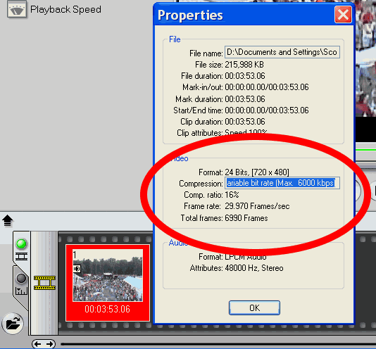

For those of you reading this thread that actually wish to do this instead of bitching and moaning here's some step by step instructions so you can truly understand how simple this is. Note this is using Video Studio 7 SE from 2003 according to the copyright on the disc. I use Uleads advanced editing app so I don't have a copy of the newer version of VS because I have no need for it, however the layout and directions will be nearly identical if not the same. These are directions for creating a standalone file, for creating discs use the tip provided previously by GerorgeW. There may even be a easier way to do this in the newer versions (like this isn't easy enough), however this method will work with all recent versions.
Step 1, drag a clip to the timeline and right click it and select properties. Note what the properties are. Specifically you need to know the Resolution, Bitrate and whether it's constant or variable rate encoding. I've circled in red where these are at in this image. Due to constraints of the dialog box size the entire properties may not be listed, simply put a cursor in the text box an move it to the right or highlight as I've done here. You may also want to match the audio settings too.

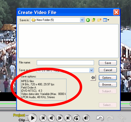

Step 3, click Share>Create Video File>Custom. Note that bitrate under save options cirled here does not match my file specs so we have to change it..
Step 4, Click options and under the Ulead Tab make sure smartrender is enabled. If the save options in step 3 match the properties of clip that's it nothing more to do. Click OK and save your file.

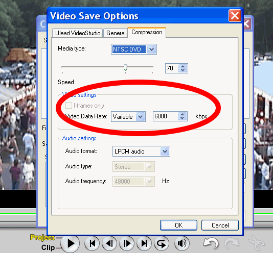

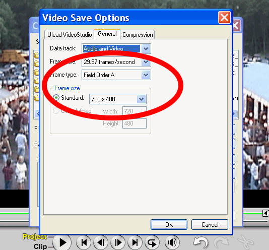

Step 5, If the save options in step 3 do not match your clip properties adjust them to match your clip properties under the general and compression tab.
