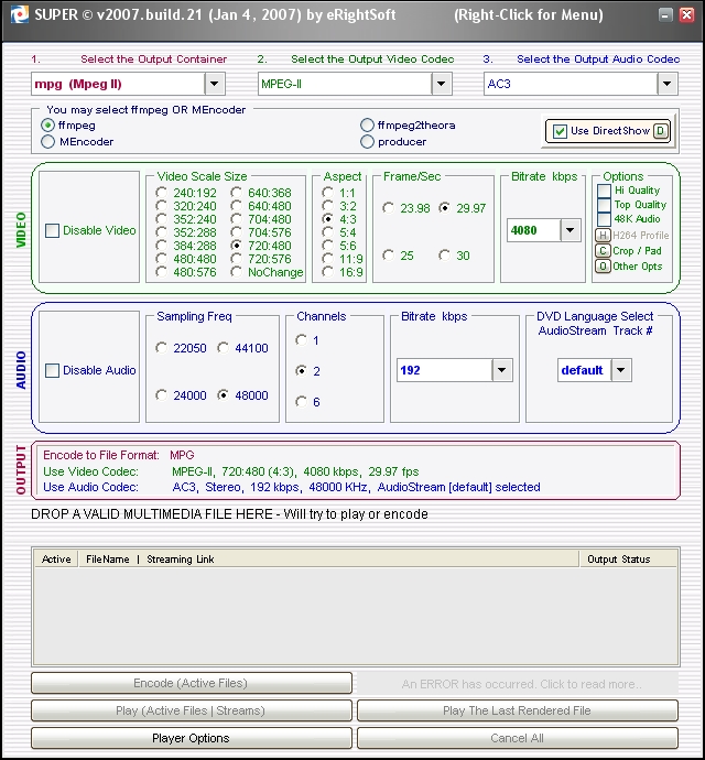

    for number 2
    try using these settings , then put it thru your authoring program

    Thewizard ...
    I tried those settings you posted, i got pretty good results, i viewed them with windows media player. I went to burn the results on to a DVD with Ulead movie Factory 3.5. When i tried bring in the files, and error popped up saying the file "contains Dolby Digital audio tracks. DVD MovieFactory does not support this audio format"

    this a fault with early versions of movie factory
    run super onthe source again, BUT for the audio setting choose either mp3 with a cbr of 128k ( constant bit rate ), or PCM sound ( windows audio mode )
    movie factory will create the dvd with mpeg layer 2 sound track

    There are programs which can accomplish every single step in the procedure. For example Super can convert the video and audio to DVD compliant streams. Then you need a program that would multiplex the streams, create the DVD file structure, create menu and add navigation and commands in a couple of service files which are understandable to a DVD player. This is authoring.
    Burning is only re-alocation of these DVD files on the media using special disc format and the physical process of burning itself.
    Let try to make all the steps required for creation of a DVD with the files you have.
    First file contain mpeg1 video with resolution 352x240 and framerate of 29.97 frames per second (fps). This stream is DVD compliant. Therefore it doesn't need convertion, it can be used as is.
    The audio stream is mpeg1 layer 2 with samplerate of 44100 Hz. DVD require 48000 Hz, therefore the file must be converted (resampled) to mpeg1 layer 2 48000 Hz file.
    Weird is that Super analysis shows wrong duration of the video stream.
    Second file has video stream of mpeg4 DivX 3 implementation at 29.97 fps with 640x480 pixels resolution. This is not suitable for DVD creation therefore it must be converted to 704x480 pixels mpeg2 29.97 fps 4:3 file (you want probably ask me why - ok 704x480 AFAIK is exactly what 640x480 is in not square pixels for TV, mpeg2 is required for DVD).
    The audio is mpeg1 layer 3 at 44100 Hz. It must be converted to mpeg1 layer 2 or ac3 DD file 48000Hz.
    Hopefuly now the settings used by theewizard make sense to you. Well, about ffmpeg and mencoder - this is realy personal preference as both are using the same encoding engine - libavcodec.

    Is mp2 (in the audio output setting)the same as mpeg1 layer2?
    THEWIZARD said to use mpeg (mpegll) for the video output container in a previous post, on my files.
    ABOND says my first file the video is mpeg1 and doesn't need converting. Which is correct, or in someway is both ways correct? If so which is the better way to go if i have a choice?

    yes mp2 is mpeg layer 2 audio
    yes meg1 can be converted to dvd without re-szing reencdoing, as long s the authoring software has that option,
    but 2 or more videos being combined onto one DVD usually means everything is going to get converted to a common res/codec some where along the line either in the pre-stages or the final stage by the authoring app
    you started out asking about one avi, it should be converted to DVD res/meg2, NOT mpg1
    if you have an mpg1 that is going to go onto a DVD by itself , and not combined with other videos then just run it thru the authoring program ( ulead ) no reason to convert it before that
    posting the super log listings of 2 different files instead of posting Gspot screen shots has caused some confusion of the issues and , what you are trying to accomplish
    you need to post A gspot screen shots of the ONE source file, then tell us what it is you want to do with that file , convert to dvd ? convert to Dvix for a standalone dvix player, convert to mpeg2 to be merged with other clips for DVD ?
    bottom line AFAIK ulead is not going to accept (2) different file formats some how before you get to ulead both files need to be the coded the same way as mpeg 2 or mpeg1, with the same audio mpeg2 layer 2 or 3, and the same frame rate
    you can covert the avi to match the mpg1 specs and give both files too ulead OR you can convert BOTH files to MPEG2 specs
    OR am i mis-understanding waht you are trying to do ?

    Ok i finally after 4 tries with each file, i was able to burn them on a DVD and it worked. Here is what i did.
    First file... kept it as a video mpeg1, but change the audio to mp2 at 48000, at 192 bitrate kbps. kept the video scale size to NO CHANGE, at 4080 bitrate kbps.
    Second file ... converted to video mpeg2, 704x480 video scale size, 4:3, 4080 bitrate kbps. Audio ... 48000, 192 bitrate kbps.
    Used ffmpeg encoder and 29.97 fps on both files. I then took both results and brought them into Movie Factory, Squeezed them into a 4.7 GB DVD using the software in Movie Factory. They came out fine. Of course not the best digital quality, but the goal of getting these on to a DVD that my player will read was reached! Thanks so much for the help from everyone. Beleive it or not you all have taught me a little something about this technology i didn't understand before. Yes alot still confuses me, so i'm sure i'll be back again.
    PS ... i thought the files were originally AVI files but it turns out they were mpeg files all along. is that correct? or am i still confused? Thanks again!!!!
    Reading again about how you have done it, I think we have taught you not in the best way. Well, you need to understand that every reencoding of the source file will lead to decreasing the quality. Now you have reencode your files TWICE (once through super and second time through Ulead machinery) and this is not acceptable (for me anyway) moreover that your first file is already very low quality. That is probably why the result you obtained is
    Here I would like to describe how I would do this conversion.
    Now I understand that you are biased to use Ulead application, probably because it comes with a device you bought and in this sense it is free for you. To make it easy from this point of view all aplications which I gonna use in my explanation are free (at least for what I am using them)
    Firstly I would demultiplex the mpeg1 file (if you have extension .avi, rename it .mpg) with TMPG mpeg tools (File - mpeg tools - simple demultiplex) to elementary video m1v and audio mp2 files. Then I would load the mp2 file in super and set it to output ac3 192 kbps 48000 hz file. Then i would leave them as they are - a m1v and ac3 (for now).
    Now I would use a bitrate calculator to determine what bitrate I need to encode the second file in order to have both files in one DVD. The first file I would assume is roughly 800 MB. A single layer DVD would have about 4480 MB. So I have around 3680 MB for the second file. In my calculations you need a bitrate for the video around 4600 kbps and 192 kbps for the audio. Then I would set super to encode the video of the second DivX3 640x480 file to mpeg2 704x480 4600 kbps 29.97 fps and the audio to 192 kbps ac3 48000 hz everything with ffmpeg.
    Now I would use GUI for DVDauthor, setted upon start up (General settings I think) to Use Titlesets and to NTSC. Here I would load the video for the first file and in the dialog -the audio for it. The I would load the second file (should be already mpg) and edit (maybe) the text and activation appearance (this is the menu creation). Click Create DVD. Once the Video_ts forlder is there I would test it in MPC (drag and drop the folder)
    At the end I would burn the VIDEO_TS folder with Imgburn (Build Mode)
    And that's it. Hopefuly it will help you get "better digital quality"
