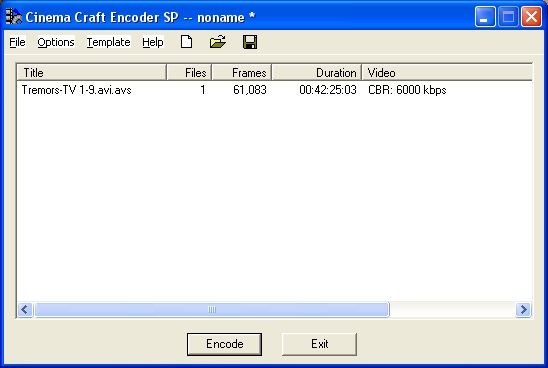

start CCE then drag & drop script in to the window# -= AviSynth v2.5.7.0 script by FitCD v1.2.8 =-

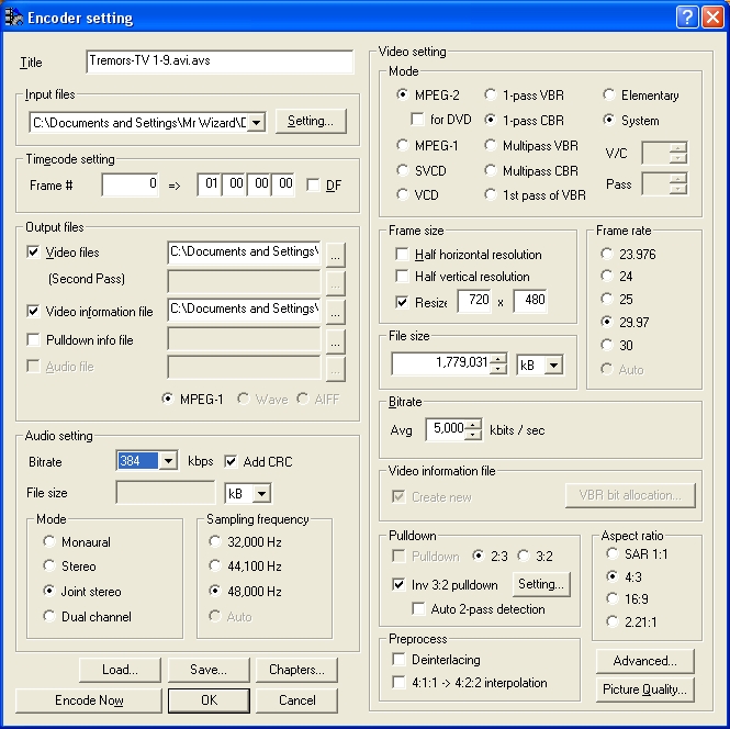

double click on the file inside the cce window and get this
note the 740 resize is checked, the bitrate was lowered from 6000 to 5000, this assures that (2) episodes will fit on one DVD, the frame rate set to 29.97 and pulldown is on
audio bitrate set at 384K the same as the file

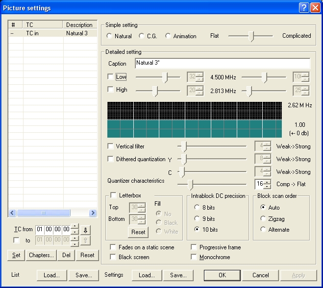

now goto the picture quality window
and set it to look like this
close the , click apply an OK and then OK on the setup window then click encode

There are some strange things in your setup there, but I'll just mention this:
The framerate is, indeed, set for 29.97fps, and therefore the Pulldown box is greyed out, as you don't apply pulldown to a 29.97fps source. What you've checked is the Inverse Pulldown box (IVTC box). If your AVI is really 23.976, you don't apply IVTC. If it's at 29.97fps, then the chances are very good it can't be IVTC'd, since it's been resized (and probably deinterlaced) already. To apply Pulldown, you have to first select 23.976fps (and do that only if the source AVI is really 23.976fps). -
let me apologize and make a correction
in my actual run , processing this file, several weeks ago,I did not change the frame rate, the file was outputed at the input frame rate 23,976
I let convertX worry about changing it to nstc 29.97 TV video
when i set this up to take the example screens shots for the post, I choose the wrong setting for the screen shot
