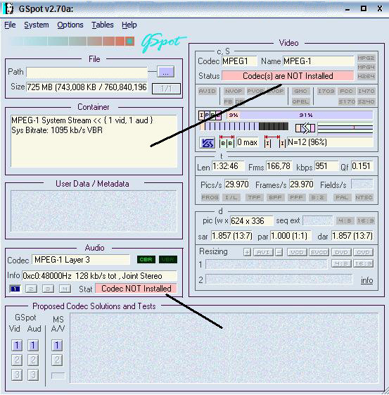

    I have a gspot snap below which is saying no codecs installed but I am sure i have them installed for video mpeg-1 and mpeg-1 layer 3 for audio

  9. Член BJ_M's Avatar
    Jul 2002
    Canada
    see this http://support.microsoft.com/kb/909596
    and/or install DirectX 9.0c
    and/or replace ALL copies on your system of quartz.dll (there may be more than one and they might not match) with the latest version (you can google for it) -- it will be 6.4 (if xp sp1) or 6.5 if sp2) (or just reinstall dx 9.0c)
    or (try this first) Click on Start > Run... > and type regsvr32 quartz.dll
    also - remove duplicate copies of quartz.dll -- just one in the system32 folder
  10. Member loa909's Avatar
    Mar 2007
    all ok now thanks it was what you said quartz.dll I updated to v6.5 and gspot now says codecs installed
    loa909, do your MP3 files open in Goldwave now? In your other thread you were having problems with opening AVI with MP3 in Goldwave.
    Also, the MPEG-1 with MP3 audio that is listed in GSpot is kinda strange.
  14. Member loa909's Avatar
    Mar 2007
    yes works fine now in goldwave aslo i dont know what u mean by Also, the MPEG-1 with MP3 audio that is listed in GSpot is kinda strange
    Nov 2002
    The file that you showed in your GSpot screenshot is shown as MPEG-1 with MP3 audio. All of the Mpeg-1 files that I have seen have MPEG-1 Layer 2
