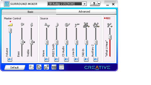

I have gone through the volume controls, all the levels are turned up full, none are on mute. I have also run the Windows Xp Video Decoder Checker and the settings are fine.

The image below shows my volume levels

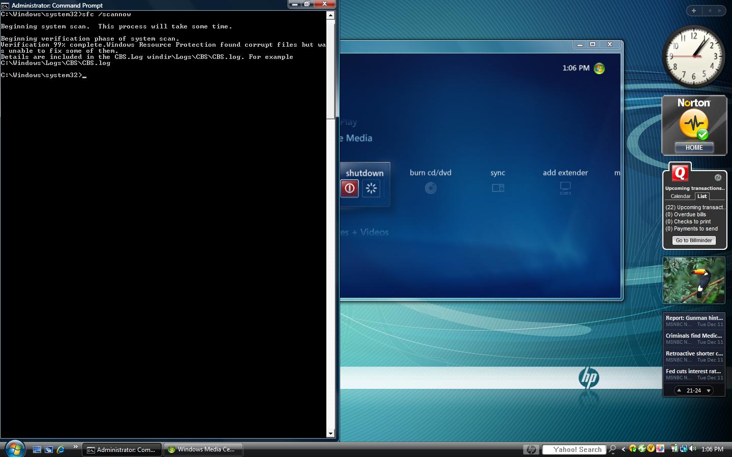

This problem just surfaced one week ago, after I performed a windows media center new setup from a cable box digital connection to a direct cable analog connection. Also, at one point, I was able to get live tv via the digital antenna . . . now the reception is a non-starter. Attached, fyi, is a screen shot of the unfixable error from sys file checker.
Our best guess is that I have corrupt or missing codecs or there is a corruption in the Media Center Software. Sure wish that Microsoft would step up and acknowledge this problem and provide us with a fix. Hard to believe that they have been ignoring this problem since last March. Very frustrating.

in original windows master volume control (icon on taskbar - dobleclick) - Options - Properties - look for choice of mixer device. Select your tuner >> check all boxes >> OK.
Here i saw both sliders set to zero. That was a problem! I set needed volume and enjoyed. BTW it reacts with little timeout - about 2 secs.
