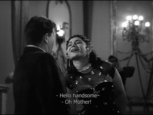

Hello, I have a movie with subtitles already burned into it. The video file is avi format, xvid.
The problem is the subtitles are too small, and since it is burned in already, i cannot just increase the font size through a video player. Is there a way that I can increase the font size of the subtitles in the video file, without ripping the subs and editing the the sub file, and then re-encoding the video file with the new subs?
I hate using vdubmod for encoding a subtitle in a vid since you reduce the quality of the video (especially since you cant, or at least to my knowledge, re-encode with xvid). And using autogk takes a long time...
So Is there any way to increase the font size of the subtitles without ripping the subtitles out and doing all the stuff i just mentioned above?

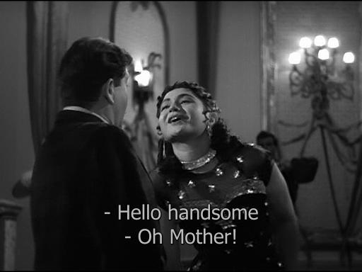

You're right in thinking you can't adjust the font size when you have SRT subs. You can make them larger using SSA subs.
Open your SRT subs in SubResynch. It comes with the VobSub package. Save as SSA. Open the resulting SSA subtitle in Notepad. Near the top you'll see:
The boldfaced number after the font name is where you change the size. If 50 is too small:Style: Default,Tahoma,80,12500670,12303291,12171705,0,0,0,1,2,2,2,30,30,80 ,0,0
then change it to 80 (or whatever you like):
Test them before encoding them into the video. Remove the SRT subs, name the SSA subs the same as the movie, play the movie and check if the size, font, color, positioning, etc., is to your liking. You shouldn't have any trouble telling the larger SSA subs from the smaller burned in SRT subs. -

There you are - Convert to .ssa, change font size, and reencode.
/Mats -
thank you manono that worked... and thanks to everyone else for your suggestions.
