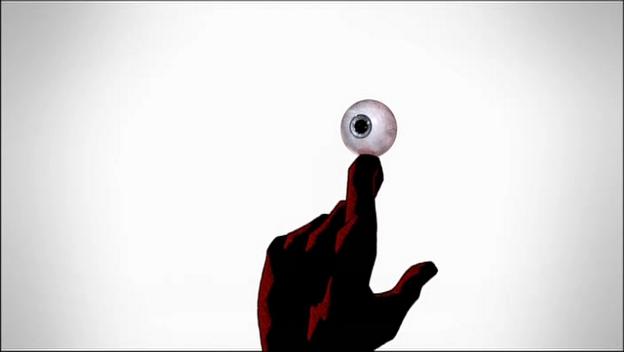

Is there a chance you can post a pic of the video? Something that shows the bad aspect well, perhaps even something that's supposed to be round, like a sun, moon, or ball? I have an idea what happened, but would hate to send you on a wild goose chase. Also, how about a GSpot pic so we can see its properties? If this is a well known movie, would you mind giving the name? That might help in figuring the AR it's supposed to have. -
Looks like it is supposed to be 16:9. Whoever encoded it didn't know what they were doing. Vertical resolution is more important than horizontal, yet they stretched it horizontally rather than vertically (as on anamorphic DVD's).
I would suggest that you try 16:9/1.78 and see how it looks. -
Exactly how would I do that? I assume by resizing in vdub, then frameserving to tmpgenc? But how do I determine the right dimensions? As a test, I tried resizing to 576x288 and it seemed to look ok, but I can't be certain. Sorry, but I'm no expert.I would suggest that you try 16:9/1.78 and see how it looks.
I think what I suspected is true, and as celtic_druid said, whoever did this didn't know what he was doing. I think the vertical resolution was just cut in half, with maybe some cropping of black on the left and right sides (or maybe not). I use AviSynth (as should you). My script for the picture alone is:

Thanks, it looks about right. But can I ask how you determined that 624x352 was the right dimensions?
Aspect ratio calculators help a lot, but pretty soon you'll just remember those magic numbers in your brain.

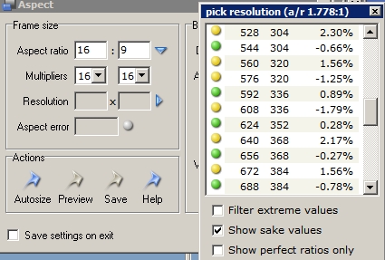

Yes, my method was similar, sort of. I first made the script for 704x576. I doubled 288 to bring it back to 576, following my hunch that some idiot had just cut the PAL vertical resolution in half. I opened my script in GKnot, went to the Resolution Tab, set the Input Pixel Aspect Ratio to PAL 16:9, and checked various resolutions for low Aspect Error. 624x352 worked well, so I changed the resolution in the script to 624x352. Then I opened that script in VDubMod and took a picture.
As Soopafresh's pic shows, 592x336 also works well to resize without doing additional cropping, as do 656x368 and 688x384. -
16*352/9 = 625.78 and the closest number divisible by 16 is 624. You don't need any special calculators or anything to work that out.
