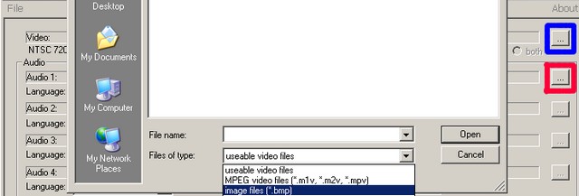

    Hit the Video button (blue) to load the BMP. Hit "Close" in the new screen. Then hit the Audio button (red) to add your WAV file. Hit "Close". Give it a "Destination Folder" and hit "Start".

    Tried Muxman again: (I didn't realize that the buttons would work; normally greyed-out means not available). It accepts the BMP but rejects my WAV file. (Windows Media Player plays it properly.) Any idea why?
  10. Any idea why?
    No, except there's something wrong with it (not 48kHz maybe?). WMP playing it isn't the same as it being DVD compliant. If you have access to a WAV editor, I might suggest taking an already existing WAV file (or make one from a small AC3 track from a DVD) and seeing if Muxman accepts it. If it does, then open it in your WAV editor, cut it the length you need, and lower the amplitude to 0, so you can't hear anything (if a silent WAV is what you want). Save it and then try again. Or create one at 48kHz this time?

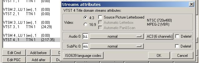

  13. Yes, as guns1inger says, encoding for 16:9 in the first place would be better. Then Muxman will show it as 16:9. But if you did it wrong, you can also change the DAR of the MPV or M2V using ReStream before authoring. And if you've already authored, in addition to changing the DAR in the IFOs using IFOAR2WS, PGCEdit can also easily do it.
    Open the completed DVD. Right-click the video in question and hit "Domain Streams Attributes". Change from 4:3 to 16:9 Automatic Letterbox, OK, Save, Test, and burn.
