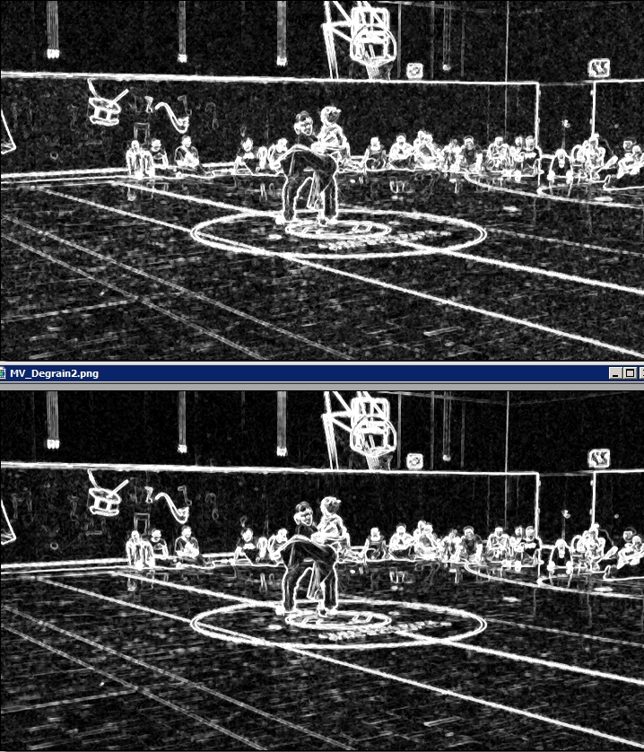

Just in case, here's the Avisynth script, complete with required plugins - you'll just need to install Avisynth if you haven't already. Also, Quenc is a very good Mpeg1 encoder.
dv_enc.rar
quenc071.rar
Top pic is without Avisynth degraining, bottom pic is with. Image is masked in order to show the noise.
z3.jpg -
