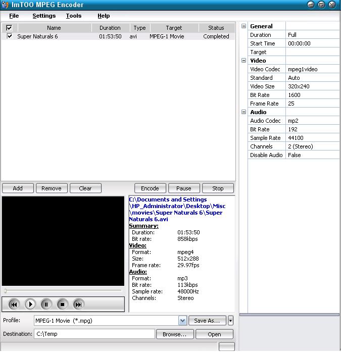

before the conversion the file came as a AVI, which i then changed to MPEG-1 (*.mpg) using "im too MPEG encoder".

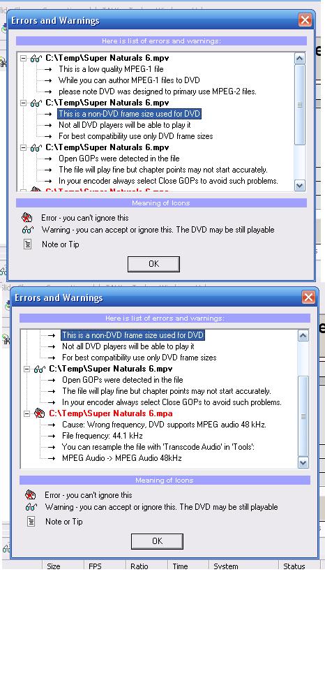

and these are the messages that appear when i open up each file in DLP

your frame sizes are wrong....use 720x480 in ImToo....scrap ImToo, use a better encoder...use Mpeg-II

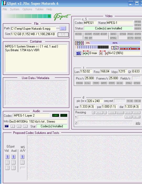

The 320x240 resolution is not valid for DVD -- so that might be the issue -- try making it 352x240 (if you are doing NTSC, and also 29.97fps).
Also, the audio should be 48khz (not 44.1khz that you have).
Also, are you trying to do a standards conversion (NTSC to PAL)? Not sure what you got there because it's 25fps (according to GSPOT), but your resolution looks like NTSC -- so should it be 352x288 for PAL (25fps) or 352x240 for NTSC (29.97fps)?

Well, no big wonder it looks odd. (The wonder is how you could at all expect it to work, after all these warnings DVD-Lab gives you!)
Like previously stated, use DVD video std resolution and audio sample rate. (See WHAT IS DVD top left)

"im too" software doesnt allow me 2 alter the sizes of the movie, what shouuld i do? i've been lookin around for some good freeware, but havent had any luck, any suggestions?
