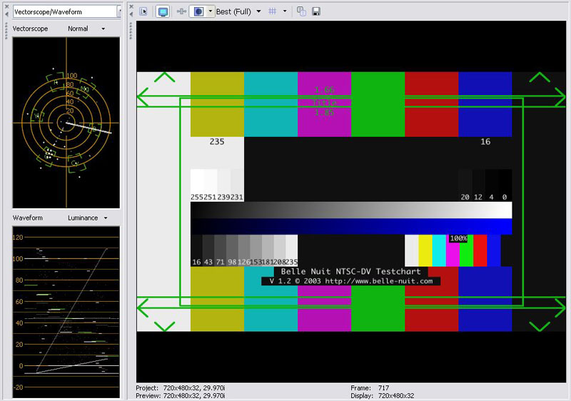

    BYW, the Belle-Nuit color bar is perfect for getting the monitor set up to proper DV levels. Unlike the Canopus ADVC-1xx, camcorders don't add the 7.5 IRE setup needed to match normal analog TV brightness so you need a custom monitor setting.
    http://www.belle-nuit.com/testchart.html
