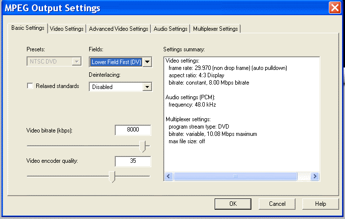

    Best program for direct on the fly MPeg2 encoding from DV input is the standalone Mainconcept MPeg2 encoder v1.5. I do this from my Canopus ADVC. It must be v1.5. v1.4 requires a device control dialog that hangs for other than camcorder input.
    You will need a fast processor to keep the buffer from filling. A P4 2.8GHz. is on a the hairy edge*. You need to strip out all the background processes to make this level machine work. I'm assuming you want reliability here so use a fast enough machine.
    Now I'm using a Core2Duo with no problems. Try the demo first.
    http://www.mainconcept.com/site/index.php?id=813
    http://www.mainconcept.com/site/index.php?id=824 <<<<
    Premiere 6.5 and Premiere Pro 1.5 owners can get this for $49. Premiere and Vegas versions of this encoder do not support MPeg encoding during capture.
    * the more you compress or the more you push VBR, the more CPU you will need. Mainconcept says
    "Processor: Intel® Pentium® III or AMD Athlon with 800 MHz or more
    RAM: 128 MB RAM, 256 MB RAM recommended"
    but my experience shows P4 2.8 and 512MB RAM is minimal.

    Basically, the way I read you, you want something that cam "stream" as MPEG
    (direct to mpeg) from a DV source, during your rush-hour business. I can
    understand this. We all can.
    So you want:
    DV Source -> Computer -> real-time -> MPEG
    in real time, and presumably, in least amount of steps.
    I'm not sure about this part, (least amount of steps) though. But I think that
    in this circumstance, you will have to jugle a few things around in order to get
    to the:
    DV - real-time - to MPEG
    and with good "production" or "broadcast" quality.
    The only problem with going this route (dv -> real-time -> mpeg) is the
    initial start up of the recording sequence. This takes several seconds or
    more to begin the recording. The reason-- My guess, is that it is on account
    of *these* softwares: Internal Preporation and Caching. Even hardware MPEG
    encoder devices have this same weekness. But other than that, real-time
    encoding to mpeg is not such a bad idea after all, if you use the right
    configuration paths.
    Finding the right conf. path may be different for each persons' setup.
    So, you may have to trial 'n erro it until you feel you have found it.
    But, if you ask me, (and I'll tell ya anyways) if you want the optimum
    configuration path, its simple. Use CBR and the highest Bitrate you can
    afford for your project. Some say 7000, but I prefer 9000 because I know
    that this is a pretty high bitrate, but it will also allow even more than
    an hours worth of video per disc. But there is room for other things but
    that I won't go into here, about this.
    For example, ULead's mpeg-2 bitrate MAX seems to be 8000. It has a listing
    of available bitrates to choose. Depending on your source quality level, you
    may not need anything more than 7000 to 8000 bitrate, which will be more than
    enough for a disc project.
    In my next post (below) I'll descbribe the basic steps to get start in
    capturing to mpeg with a dv device, real-time.
    -vhelp 4225

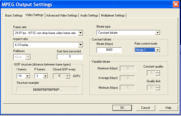

    Ok, next, you want to configure your real-time MPEG profile to capture as.
    So, now go back Capture Settings and perform some "MPEG-2" configurations for
    your next DV - real-time - MPEG-2 capture. It would be best (IMHO) to use
    CBR and a high bitrate, such as 8000 for starters. I think that's the limit
    in ULead's setup. But you can configure a "manual" setting, though in a
    hidden dialog.. <<this for another time, I guess>> Anyway.
    ** select MPEG Settings
    The default for Audio is "MPEG Audio @ 384k @ 48k Joint Stereo"
    If you need to make any changes to this, then the only one you can use is
    the following.
    ** (o) LPCM Audio, -- which uses "LPCM 48k Stereo"
    Audio is your choice for this example scenario. Remember, there are some
    compremises under these circumstances.
    My Advice would be to-- Play around with the MPEG Settings to get the best
    results you can live with. For broadast (just an opinion) and max quality,
    you might want to consider always using CBR and not VBR, because in this case
    (real-time capture) is more intensive for VBR than CBR. And with this amount
    of resource loss, you want the most effeciant that you can provide to your
    capture equipment.
    My *other* advice would be to--use (o) LPCM Audio and convert that to
    AC3 or other.
    Everything else is experimental.

    Mar 2007
    Wow thanks for all the details!
    We have a few versions of Ulead DVD Workshop. I was looking in there to see if I had any options, but didn't figure anything out on my own. I'll take a look at it next chance I get, following all of your directions and see if I can get what I need. We might have other Ulead software, but DVD Workshop is all I'm aware of.
  16. Member thecoalman's Avatar
    Feb 2004
    Pennsylvania
    It will, I have version 1.3 but if you have 2.0 the directions should be similar. Your device should be plugged in a recognized at this point. Click capture on the top. Under options click "Change capture plug-in" and switch it to MPEG. On the capture screen there should be a cog wheel, click it to set the MPEG options.
