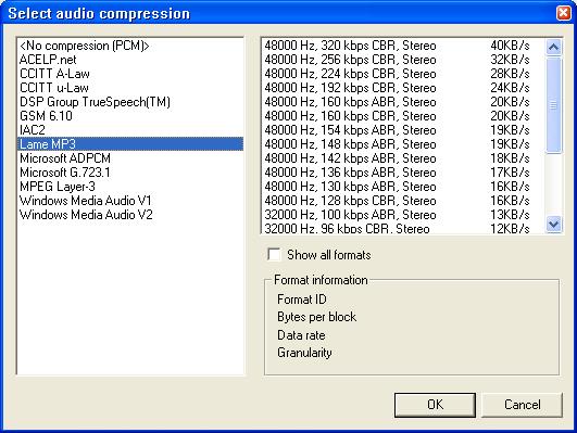

  25. Always works for me:
  26. It's not there.
