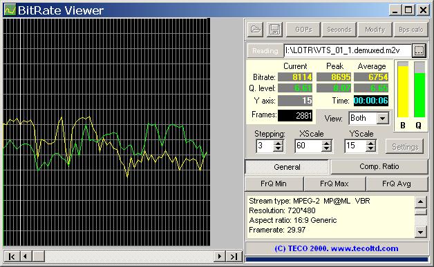

    If you're worried about your bitrate "spikes", get BitrateViewer or similar. Or use an encoder that you have good control over --and control it!.

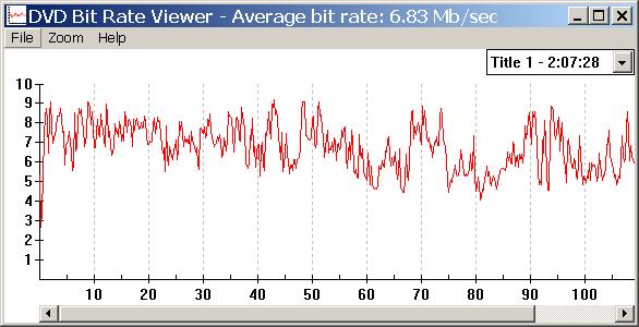

    Here's a bitrate graph (DVD Bit Rate Viewer) for Casino Royale:
    http://www.dvdbeaver.com/film2/DVDReviews28/casino_royale.htm
    The max shows at just under 9000. Those graphs he uses are zoomed out 3x and it's hard from that to guess the real max bitrate, but I'll just call the max at 8900. Subtract out the 3 audio tracks and you have roughly 1100 less, making the max video bitrate somewhere between 7500-8000, 7800 or so, 41% greater than your assertion. That's very conservative, that estimate. I'm using this as an example as it's a very new release. Another is this one for Rocky Balboa:
    http://www.dvdbeaver.com/film2/DVDReviews28/rocky_balboa.htm
    Pretty much the same thing. This one for Blood Diamond is somewhat lower:
    http://www.dvdbeaver.com/film2/DVDReviews28/blood_diamond.htm
    but Warner Home Video is known for being more conservative, and the max video bitrate is probably 7-7500. Theirs always show the max as 7500 in the headers (which, of course, isn't necessarily accurate).

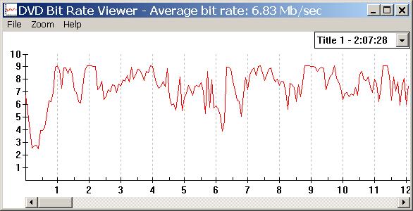

    I don't own many new movies on DVD. I checked out the first disc of LOTR-ROTK-EE,and found this:
    That's zoomed out 3x. Zoomed in 3x, it's this:
    The BitrateViewer graph shows this:
    but it can't be trusted as it often gives higher figures than is accurate. This is from one of the chapters and shows (wrongly) the max video bitrate as 8695. DVD Bit Rate Viewer is accurate for all the assets together.
    So the max bitrate for all assets and overhead is about 9000. There's a DTS track at 768, a DD 5.1 track at 448, and 5 DD 2.0 tracks at 192. Subtract them all out (and the subs and overhead) and you're left with a max video bitrate of about 6700-6800. And that's a pretty extreme case as they decided to squeeze in way too much audio. Many DVDs have been criticized for that, as it can hurt the video quality. As has been mentioned, Hollywood can do things to prevent artifacts which we may or may not be able to do ourselves, such as smoothing complex scenes, and/or using Adaptive Quantization. I know LOTR-ROTK uses Adaptive Quantization, and it's the first DVD I ever saw that did use it.
