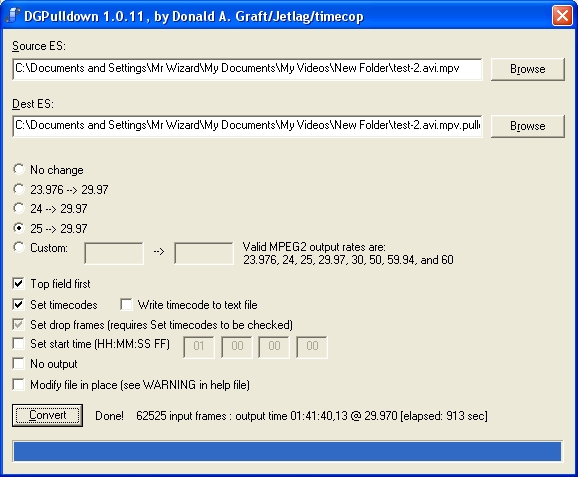

but if i have an MPV file that will elementry with NO audio
dgpulldown is going to make the 29,97 ntsc m2v in sync with extracted audio file ?
in this case which file should i use AC3, wav lpcm, mp2, mp3 ?
or do i have to process the audio file before I can mux it/author it -
So it is a frame rate conversion problem...
Just search the forum, there are hundreds of posts for that matter.
If you use CCE + dgpulldown, you should use an AC3 file (best quality and 100% NTSC compliant).

update
extract audio saved as AC3
convert avi source file 696meg to mpv using cce with script from fitCD , output 740*480 25fps 3.48 gig ,
run DGpulldown 150 min output file m2v 3.48 gig
use muxman to create video_Ts & vobs 40 minutes
burn & test , no chapters, plays good, looks good, boxed but not squished, aspect looks good

*creating MMback.m2v
if muxman does it 40 minutes on the same PC and the same with the same m2v & AC3 , same drives, why do you think its a drive problem, what can be done about it , and why is GFD & mplex using so little CPU cycles and going so slow
DGpulldown was very slow slower than realtime play of the file, any ideas on that, there were no errors displayed

DGpulldown was very slow slower than realtime play of the file, any ideas on that, there were no errors displayed the test-1.avi-mpv and the pulldown m2v version both exsisted on my 'C' drive,
Yeah, DGPulldown doesn't give you the choice of saving to a different drive. To check for PIO Mode. Go Start->Control Panel->System->Hardware->Device Manager->IDE Controller.

I defrag 'C' drive twice, ( it was pretty bad) and that appears to be a big help, I have run a test with a smaller file 351 megs 42min runtime AVI Xvid codec
CCE covert to mpv 32minutes
DGpulldown to m2v at 29.97 913 seconds =15 min 13sec
thats only 35% of the video run time instead of 150% aprox 5 times faster, ( percent wise )
i have to try CCE & DGpulldown on test-1 to see if I get the same type of increase

here is a screen shot of DGpulldown

OK i burned (3) authored versions of test2 to DVD+RW for quailty evuations
GFDauthor, GFDmuxman, and Muxman free 'as is' ( no chapters )
GFDauthor plays perfectly and displays at 16:9
GFD with muxman the audio is way out of sync running several seconds ahead of the video , displays at 16:9
Muxman by it self plays perfectly , displays at 4:3 in perfect aspect , crops the left & right edges of and fills the screen
available settings were PS, LB, both i selected both, next time i'll try PS or LB
muxman running alone 22 minutes to process the files
the same (2) elementry streams m2v & AC3 were use for all three trials -
That's interesting. So for NTSC MuxMan expects some more info for the video and audio files, which it gathers obviously itself in GUI mode, but not in 'command line' mode...GFD with muxman the audio is way out of sync running several seconds ahead of the video , displays at 16:9 + Muxman by it self plays perfectly
Could you do me a favor?
Run MuxMan by it self, save the mxp file from the MuxMan GUI and send it to me together with the muxman.mxp file which was created by GfD in MuxMan mode. You don't need to reauthor everything, in the MuxMan GUI just save as project and in GfD use the 'create batch' button.
I am curious for the differences...GUI for dvdauthor:
