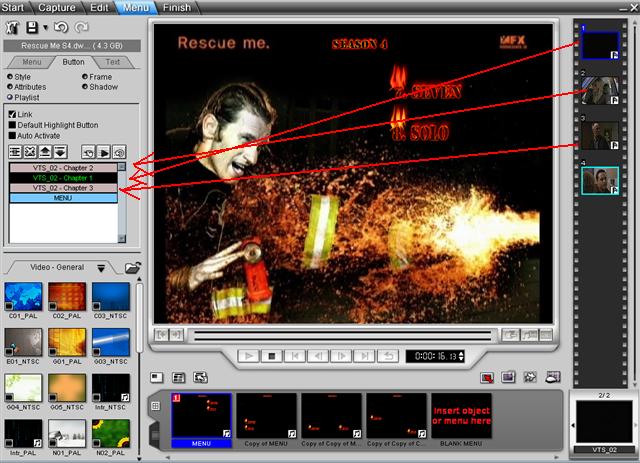

  20. Member p_l's Avatar
    Montreal, Canada
    Sure you can.
    1. On the Edit page, drag the Jog Bar to where you want to set your chapter point and click Add Chapter on the left under the Video tab. Repeat for however many chapter points you want to create.
    2. On the Menu page, highlight a button on the menu, select Playlist under the Button tab, then drag and drop your chapter points from the right into the playlist and arrange them in any order you wish.

  29. Member p_l's Avatar
    Montreal, Canada
    Thanks to GeorgeW for raising a valid point, to hech54 for trying to keep us on track and to edong for a good alternative.
    GeorgeW, you are correct that even if DVDSW allows you to add several chapters to a playlist and even change the order as illustrated above, it won't play them that way! It'll just play from the first chapter point in the playlist until the end of the track. The problem is that DVDWS doesn't seem to know when a chapter ends, and it just keeps playing the track.
    edong, I've used TDA as well in the past to do what you say, and yes, you can make a menu with chapters, by clicking Edit on the track on the Source Setup page, then
    1. selecting Chapter Cut Menu
    2. moving the jog bar where you want to create your chapter point
    3. clicking the Add current frame to chapter button.
    You can make a pretty nice menu, put the songs in whatever order you wish, and clicking the Next button on your DVD remote takes you to the next song on your menu. However, once again, when a chapter (song) is finished, the rest of the track keeps playing to the end.
    In fact, you can do the same thing in DVDWS by assigning a different button on your menu for each chapter (song), putting the songs in whatever order you wish, and clicking the Next button on your DVD remote takes you to the next song on your menu. However, yet again, when a chapter (song) is finished, the rest of the track keeps playing to the end.
    Of course in both cases, with DVDWS or TDA, you can go back to the main menu anytime, like when a song is finished, by clicking the Menu button on your remote.
    As George points out, in DVDWS you can CUT the concert into a track for each song, then use the playlist as I originally illustrated in the previous post to automatically play songs in an order you determine, and even set an end action for each song to automatically go back to the menu, but the whole concert will not Play All smoothly because there will be a slight pause between each track (song).
    However, at this point, just to confirm, since you've already ripped the concert with DVDShrink, can I ask you if you now have a single big file for the whole concert with the songs now in the order that you want, or do you have several smaller files, one for each song?
