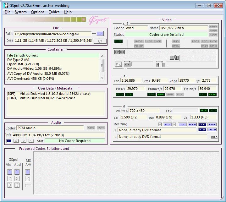

  5. Member LSchafroth's Avatar
    Dec 2002
    Here is the gspot info:

  7. Member LSchafroth's Avatar
    Dec 2002
    Apparently I pay attention as well as my team plays football!!
    WORTHLESS!!
    I was selecting the 16:9 profile when loading the AVI file into EDIUS. Once I changed it to 4:3 it no longer scewed the picture and added the black bars.
    Media Player still reports it at 640x480, but that's not the real issue anyway. Everything else reports it correctly.
    Umm....Nevermind???
    LS
