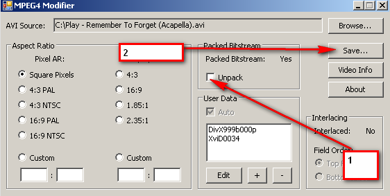

    Sure you can use packed bitstream in your player ?
    Unpack it with this and try another burn of the unpacked file. We'll get it working....
    http://www.moitah.net/download/latest/MPEG4Modifier.zip
    Jan 2006
    Australia
    one of the files I can unpack but the other file once its scanned the unpack option says "pack" Whats up with that? Should I pack it??
