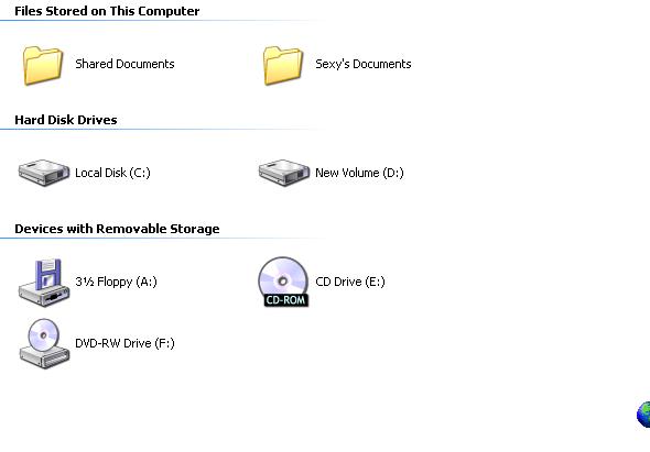

    Let me clarify something; both dvd-rws show up in the "My Computer" screen as well as in
    the "Device Manager" box. However when I put a disc into the drive the autoplay function
    doesn't come up and the disc in the drive doesn't show either. Right at this second I have a
    Creative Lab disc in that I've been wanting to install information from. As you can see the
    normal DVD-RW Drive icon changes to CD Drive icon but that as much information as I get.
    I thought that just maybe I would be able to open a window to play the Creative Lab disc
    manually but no such luck. When I open the window there's nothing there like the disc isn't
    in the drive at all! How is that possible?

    I did the following and it worked ...at least for the NEC
    3520AW dvd-rw drive.
    1. I went to the 3520AW drive and clicked on properties and clicked on the hardware tab.
    2. Clicked on the "Driver" tab and then clicked on the "Update Driver" button.
    3. When the "Hardware Updater Wizard" box opened I clicked on the second box "Install
    from list or specific location and clicked "next" button.
    4. Check the "Don't search, I will choose the driver to install" box and clicked "next" button.
    5. I chose the second listed driver "CD-ROM" Drive [force CDDA accurate] driver.
    After doing those steps I then went to the 3520AW drive and clicked on the "AutoPlay"
    options and went down the list and clicked how I wanted the drive to operate depening on
    what type of disc was inserted into the drive. It worked but as I said it only worked for the
    3520AW and that's because I have both drives on the IDE cable.
