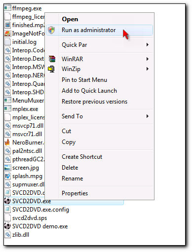

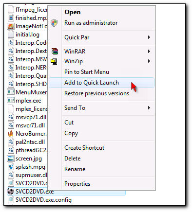

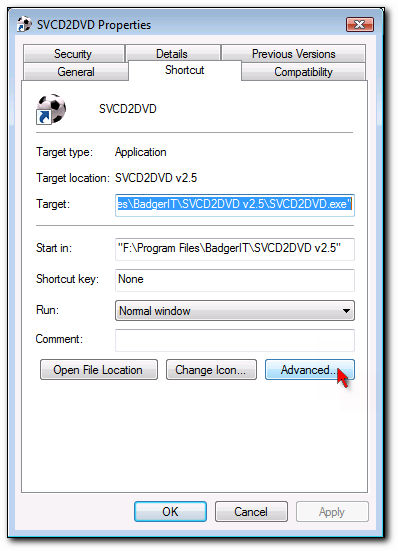

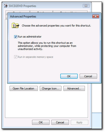

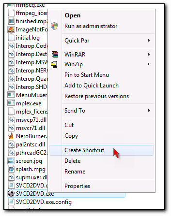

    Either:
    Go the the actual exe file (SVCD2DVD.exe) and do Right Click-> "Run as administrator"
    Or Create a shortcut (on your desktop for example) to the exe and then you can do Right Click->Properties->Advanced->Run As Administrator
    In both cases you will be able to get past this error.

  6. EXCELLENT!
    That's it ChrissyBoy you were 100% correct with your reply, i just located the .exe file in program files where it was installed as default, right clicked it and selected run as administrator and BINGO! it worked a treat.

    So, for Vista users my top tips are:
    DON'T install in Program Files directory (that caused the problem)
    DO install as Administrator (thanks for the setup.exe to enable us to do that in latest version)
    DO run as Administrator
    IF you want SVCD2DVD on your Start menu use the "Pin to start menu" option (not make shortcut) and then you can right-click it and run as administrator from there.

    Originally Posted by ChrissyBoy
    Either:
    It is also recommended that (with this version of S2D & Vista) you install in a folder other than "Program Files"
    Just to clarify... To "Run as Administrator", do the following:
    Either locate the SVCD2DVD.exe file (in the folder where you installed the program and "Right Click"->"Run as Administrator":
    OR (Recommended as this will needed to be done just the once):
    Create a shortcut or add to the Quick launch bar:
    "Right Click" on the exe:
    or
    Then locate the shortcut or quick launch icon and "Right click" on that:
    Choose the "Advanced" properties of the shortcut:
    And then choose "Run as Administrator":
    Click "OK" to all the dialog boxes and you should be good to go! Use the shortcut to run the program and so you will be always be running as administrator.
