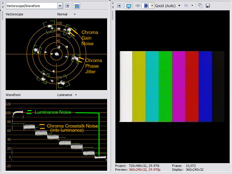

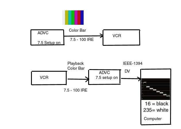

    The ADVC-100 can output its own analog color bar. You can use it to calibrate your VCR. Record the color bar to the VCR and capture the color bar playback back through the ADVC.
    If the VCR and the rest of the path is at proper levels, the capture waveform will look like this. If you have a waveform monitor you can evaluate levels and the various sources of noise.

    The test for the RD-XS35 for both paths would be:
    1. Record the color bar ADVC to the VCR.
    2. Play the VCR though S-Video directly to the RD-XS35 and record a clip.
    3. Then play the VCR through the ADVC and record on the RD-XS35
    4. Evaluate the resulting DVD MPeg2 visually and with computer analysis.
