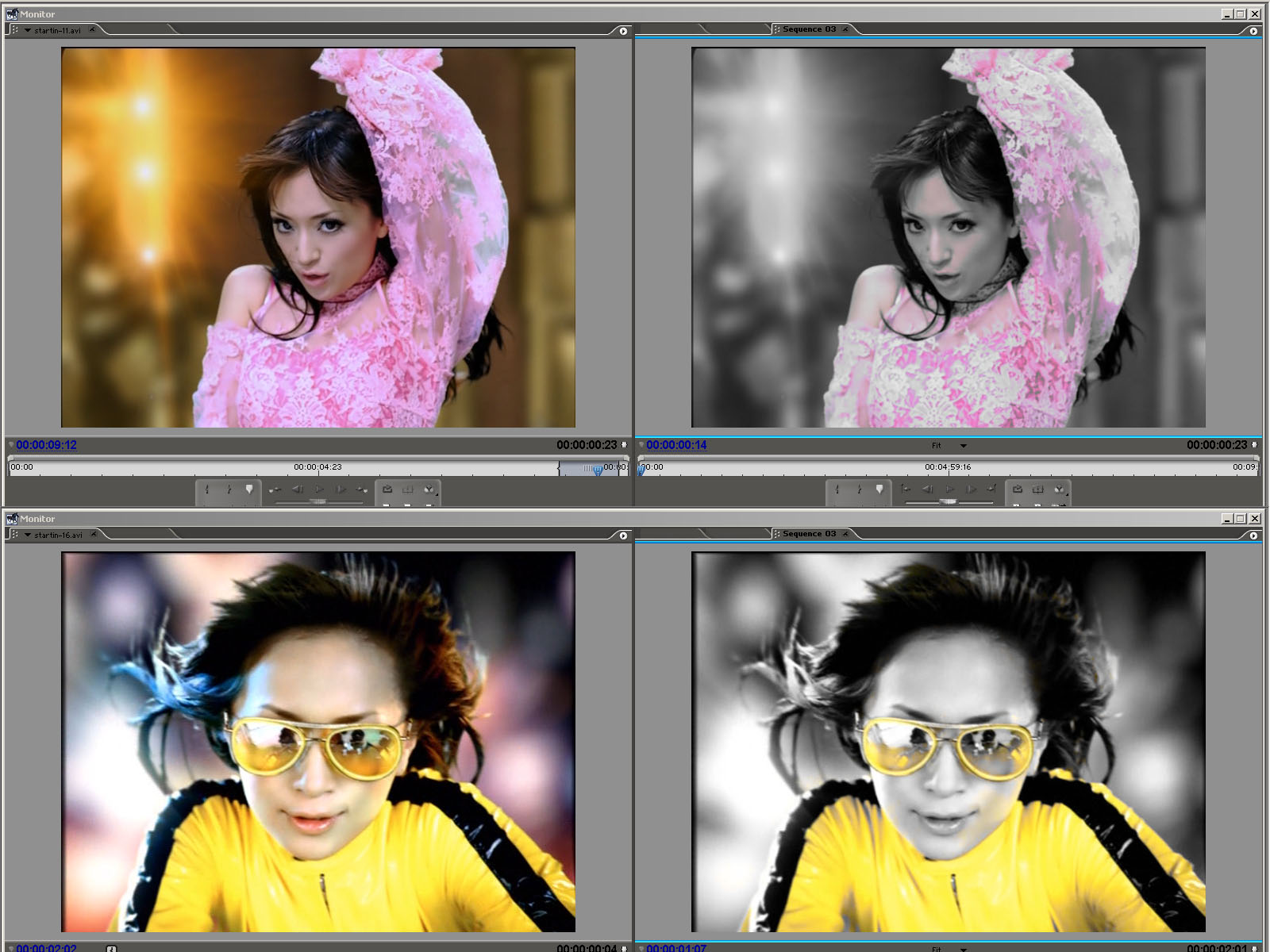

This effect is actually easier then it first appears to be.
I'm certain there is a Vegas equivalent (someone can probably confirm), but the effect you're looking for is "Leave Color."
It's available in Premiere Pro, and this is what it can do with no advanced masking:
For more complicated scenes, where colours pass over each other, etc, advance masking definitely helps.
The effect is also in After Effects and Final Cut Pro -
