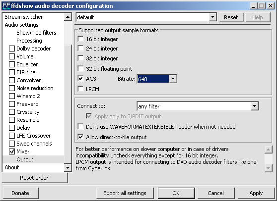

    Both ffdshow and ac3filter can realtime convert it to ac3 dolby digital 5.1.
    In ffdshow under the audio configuration set it to convert to ac3 audio:

    That sounds awesome!
    Im going to try that right now. so as i understand it, it will convert on the fly? With the mixer enabled i can play the wmv-hd dvd and get dolby digital?
    EDIT

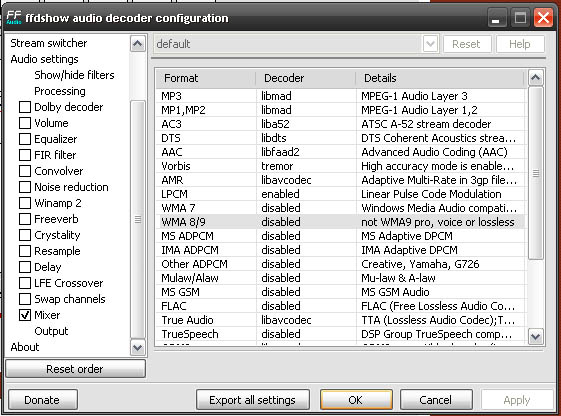

    The filter doesn't start upon playback. When looking at the codecs, it seems WM pro isn't supported

    So thanks for the help baldrick, for suggesting AC3filter, but still ffdshow does not work with WMpro audio!
