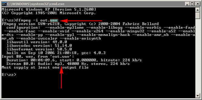

    Common problem. You're absolutely right - the audio has a .WAV extension, but your apps are claiming it is an MP3 file - that's because it IS in fact an Mp3 file. Even though it claims it is saving to wav, it isn't. I would convert to WAV with ffmpeg, saving you the aggravation of determining the actual file type - you'll know for certain the file is wav. Here's an example of the problem you mentioned:
    Quick way of creating WAV from AVI audio track.
    ffmpeg -i "yourInputFile.avi" -vn -y audio.wav

  7. WAV and AVI are a containers. They can contain audio and video in uncompressed or compressed format. The default in VirtualDub is to pass the audio through in its current state in order to eliminate generational losses. Since your AVI file contains MP3 compressed audio the WAV file will also contain MP3. VirtualDub can decomrpess the MP3 audio for you if you want:
    select Audio -> Full Processing Mode, then Audio -> Conversion. If it's not already 48000Hz, 16-bit, Stereo, then change it to that and enable the High Quality option. Now select File -> Save WAV. The new WAV file will contain uncompressed audio.
    In the future you can skip the Save WAV step and just save the audio along with the video in your DV AVI file when you Save as AVI.
