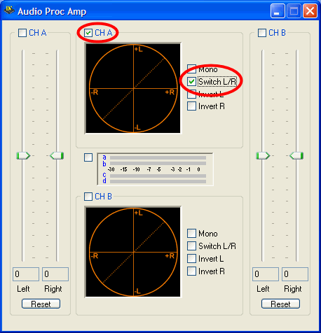

You can easily swap the left and right with our Enosoft DV Processor (since you captured to DV).
Recommended workflow:
1. In the main config settings, disable AVI navigation (this will permit faster-than-real-time processing, otherwise it will happen in real-time)
2. Select your DV AVI file as Input
3. Select a new DV AVI file as Output (Type 1 or Type 2, depending on your needs)
4. Enable the Audio Proc Amp
5. Open the Audio Proc Amp
6. Set it up like this:
(Actually, the [x] CH A is optional - it enables the vectorscope so you can see what's happening. The [x] Switch L/R is the important one.)
7. Press the Run button.
8. That's it!
Note, one of the advantages our using our software is that it leaves everything else in the DV stream intact - all the timecode, camera settings, record time/date etc etc. All that gets modified is the audio.John Miller -
