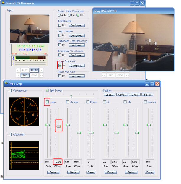

    Thank you for your reply. Do you have any suggestions of packages to brighten it up? Also, if If I change the overlay settings, do those only apply to played video and not the rest of the PC? Like games and the desktop?
  4. [quote="opflash"]
    Use our Enosoft DV Processor. It's one of the things it was designed for and is by far the fastest way to do it. Plus it is very easy. And free for personal use.
    You can apply the brightness adjustment either during capture to the incoming DV or to existing DV files on your system.
    Use the Proc Amp function and increase the Luma Offset - this is the same as brightness. It also has a split screen function to help see the before-and-after.

    Damn, thanks for that reply. that looks very useful and has screenshots. I really appreciate that! I also noticed my video looks grainier on the PC. This may help as well?

  9. Originally Posted by opflash
    You're most welcome
    The grainier appearance is probably because a PC monitor is a very accurate and high resolution display. A typical TV is rather crude in comparison and can hide a multitude of sins.
    I recommend the following workflow with our program:
    1. Set the Input to be an existing AVI or a live feed from your camcorder
    2. Since you are using Vista, set the audio options to use a non-DirectSound option (See the help file).
    3. Set the Output to be a Video Renderer.
    4. Start the processor (Run)
    5. Turn on the Proc Amp and fiddle around until the brightness is how you want it to be.
    6. Stop the processor.
    7. Save the configuration (Save... on the main window) so you can load them at a later date
    8. Change the Output to be an AVI file (Type 1 or Type 2 DV, depending on your needs)
    9. Run the processor. Now the Input will be converted and written to an AVI file. If you are using a pre-existing AVI, the processor will automatically stop when it reaches the end.
    Next time you need to adjust the brightness, simply load the configuration that you saved before and set your Input and Output as needed. If you use your camcorder as the Input, the configuration will automatically connect to it. Once you set everything up once, it will only be a couple of mouse clicks in the future to perform the brightness adjustments.
