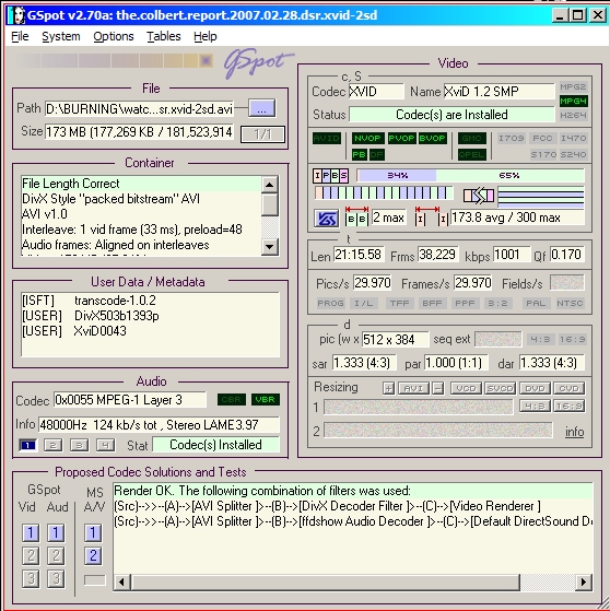

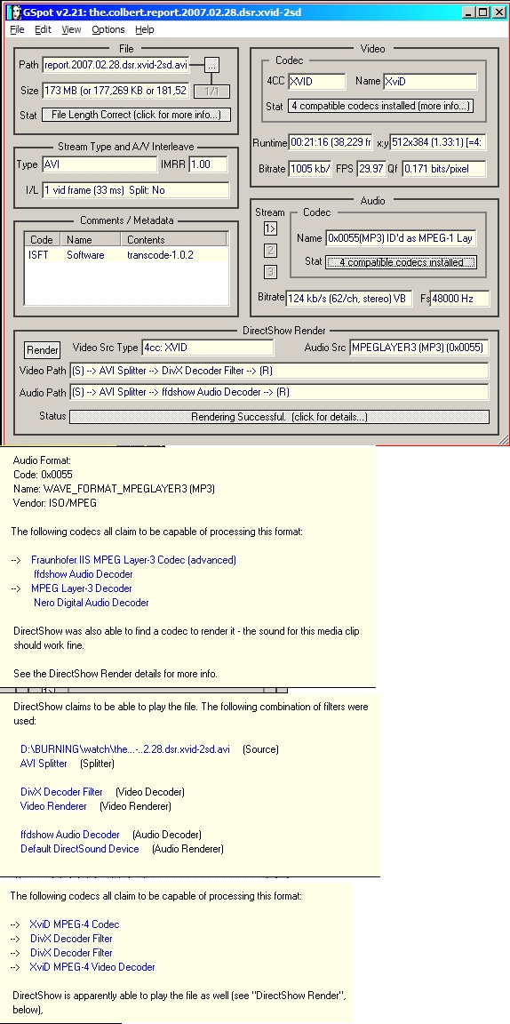

Here is the gspot info, main window and all assorted info. As you can see, it says I should play. This particular vid played sound in MPC, but no video. Others with the same gspot info only provide a black screen.
Play the file with GMplayer http://tirnanog.fate.jp/mirror/mplayer/gmplayer2007.02.14.7z
See if plays correctly with it. If it DOES, then your Divx/Xvid codec is being problematic. -
